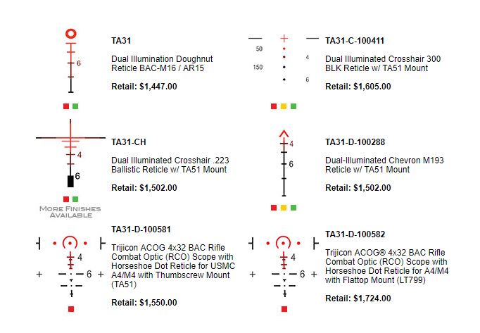

but for fast moving targets need a single infinite focus glass with simple (tactical) reticle details but those shall be thick and illuminated, something like these but for short distances let say up to 100 M....and of course a price tag....

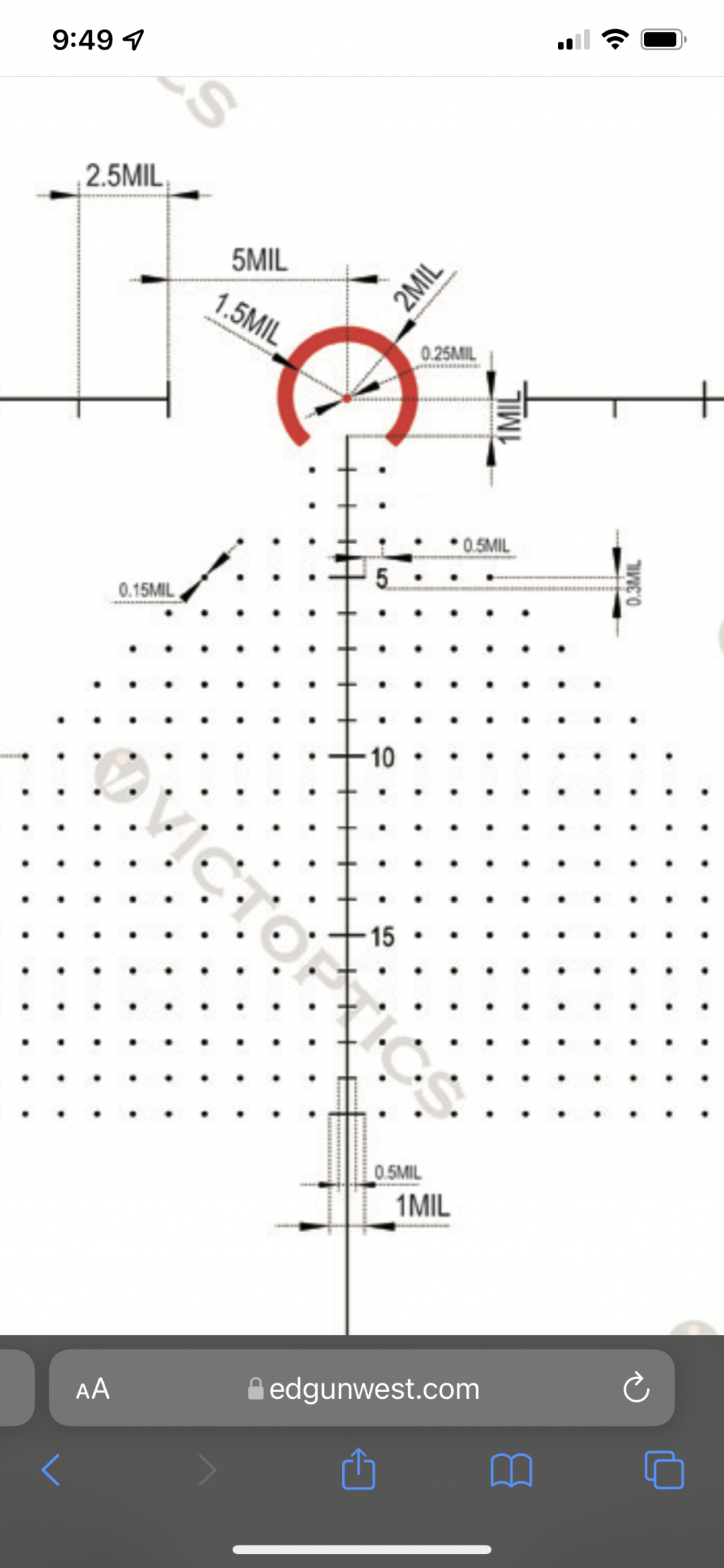

look for red dots with the ACSS reticle, they have holdover points built in (but it is catered towards MERICA 556)
you will have the same reticle (built for 556) with the sig bravo sights however. i have read the bravo is best for 100yards plus
steiner, and primary arms also have some nice prism sights that you don't have to fiddle the parallax with. i can recommend the 6x stalker as well. the highest magnification you will get out of a prism, MUCH lighter than the ACOG 6x too.
i have my L2 setup similar to Michaels. stalker on top, with an offset red dot.
look for red dots with the ACSS reticle...
Yes, that is the reticle I am thinking about it. I fully trust you if no one of these was ever built for airguns so expecting the ranging dots with rounding errors.
