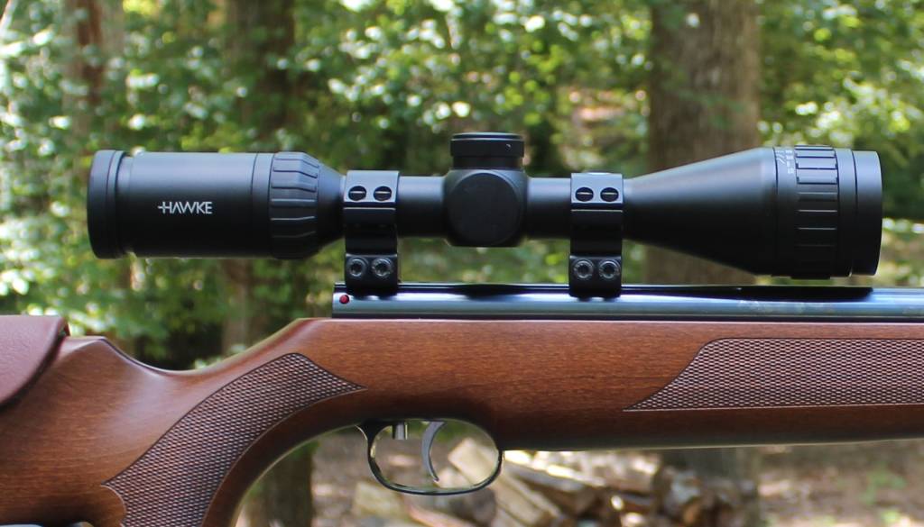

This is my HW95L with Sportsmatch T04C 2-Pc 1 Inch Medium Scope Mounts used to mount a Hawke AIRMAX 3-9x40 AO. These rings seem to work great and have a stop pin.

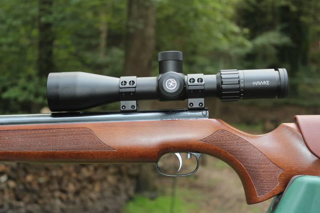

I have upgraded the scope/rings as I wanted an IR reticle and this is the new setup.

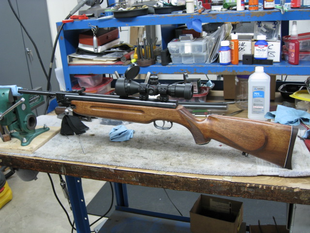

I had a set up similar to the first Deerstalker set up, but wanted to use open sights. I now have a Williams peep sight on it. It did require getting a longer elevation screw from Williams, but it works great now. And it is simple to remove if I want to reinstall the glass, I am shooting 10M rifles regularly in the house and have added the HW35E to the end of the session rotation because it is light, fun, accurate, and pretty.

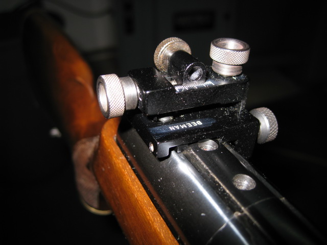

I have a Beeman/Williams Aperture Sight on my EB, and the stock Open Sights on my E. I also have a Bug Buster 3x9 Scope that I can mount on the E but I just used the mounts that came with the scope on that one. I use both my Hw 35's for iron Sight Practice Guns, hence the Iron Sights on both.

HW35EB with Beeman/William Receiver Sight.

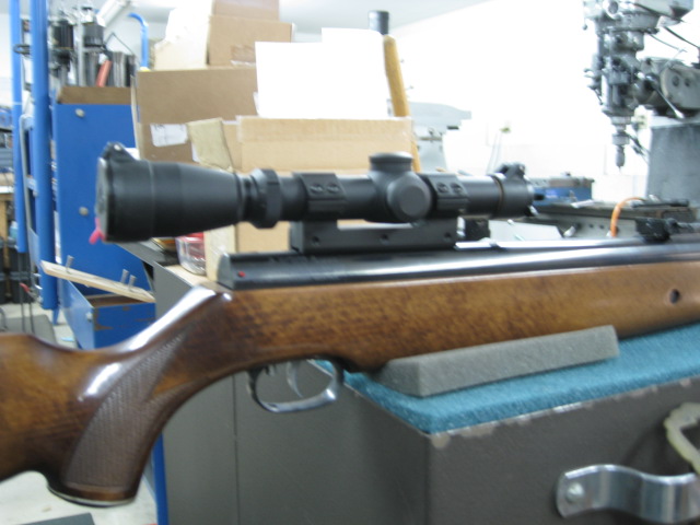

R1 with 1-4X Leupold and UTG one piece mount with stop screw. There was an earlier mount with only two screws that wouldn't hold position.
I add a stop screw to my Williams/Beeman peep sights on Weihrauch airguns. Simple drill and tap. This allows the sight more rearward and looks better/cleaner. The closer the iris is to the eye the smaller the hole can be. Accuracy really improves. You are lucky to find two 35’s without barrel Droop. Every one I‘ve ever seen has had barrel droop. It’s either by design or because of the positive locking latch. Never exactly understood it.

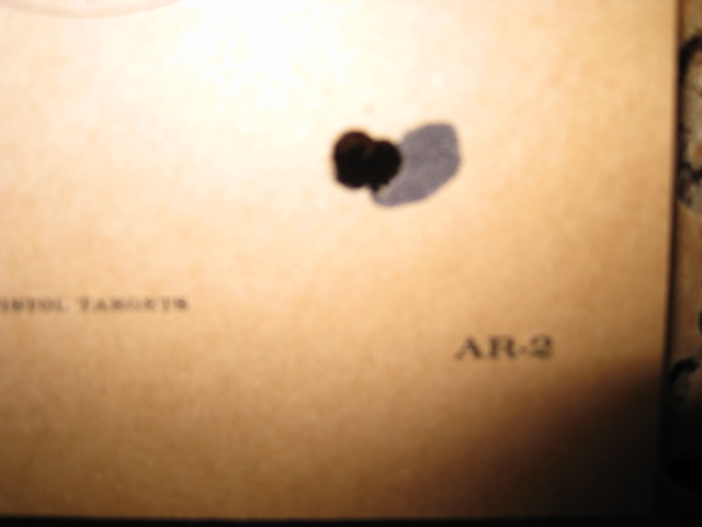

Here's a pic of the E with the Scope mounted to shoot groups to figure out which pellets shot the best. After 40 years of thinking H&N Wadcutters were the most accurate, JSB Exacts took over the top spot. That's not 3 shots,,, It's 5 !
