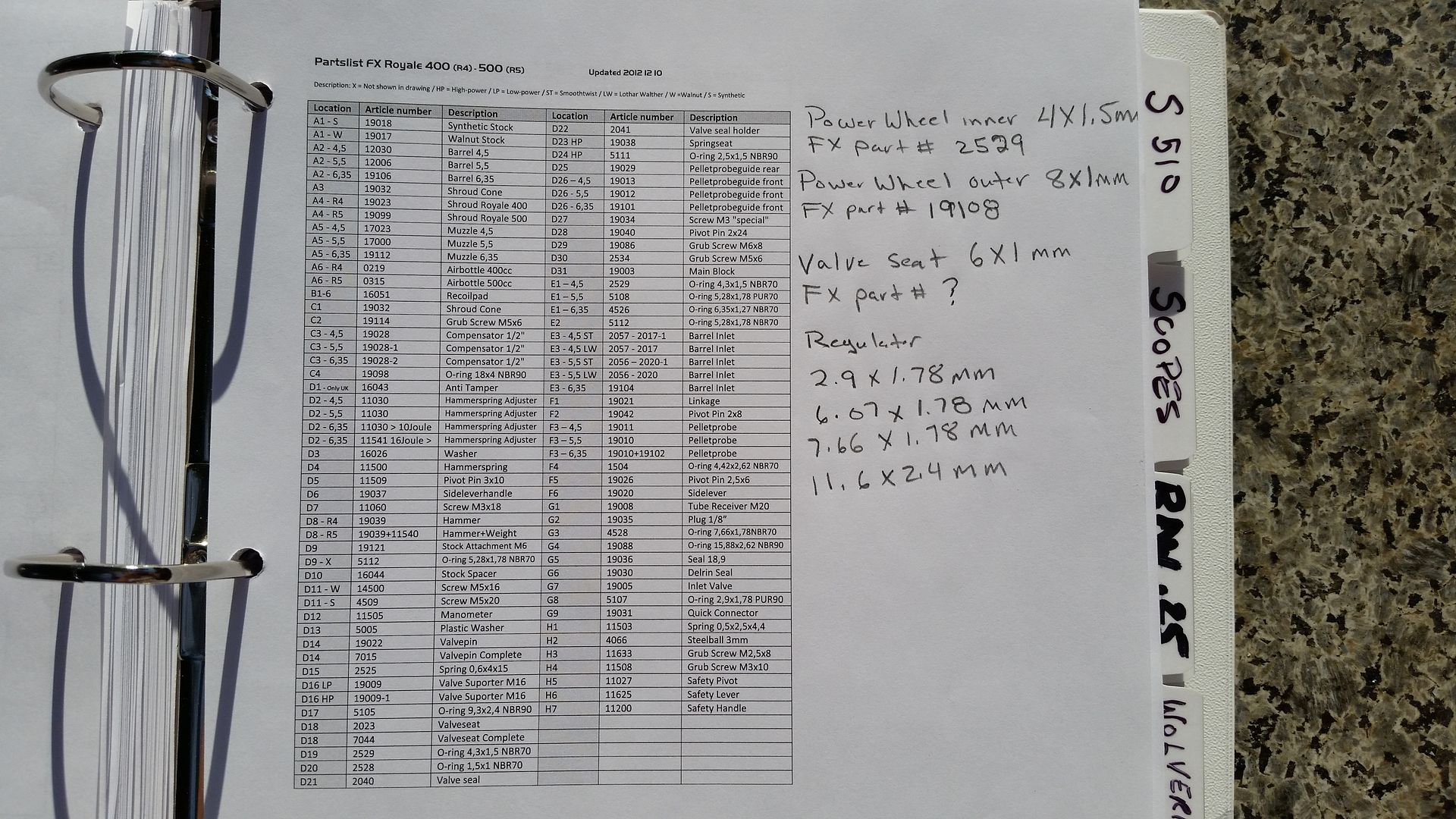

Another thing I may add some of those kits may be for overseas spec guns. When I ordered one for a Royale they did not include the regulator, power wheel and large valve seat o'ring. AOA sells factory kits that fit in the $40 range. I am building logs on all my guns with o'rings and parts.
http://www.fxairguns.com/wp-content/uploads/2015/10/wild-exploded-drawing-AoA.pdf
http://www.fxairguns.com/wp-content/uploads/2015/10/Royal-Drawing-and-Partlist.pdf
