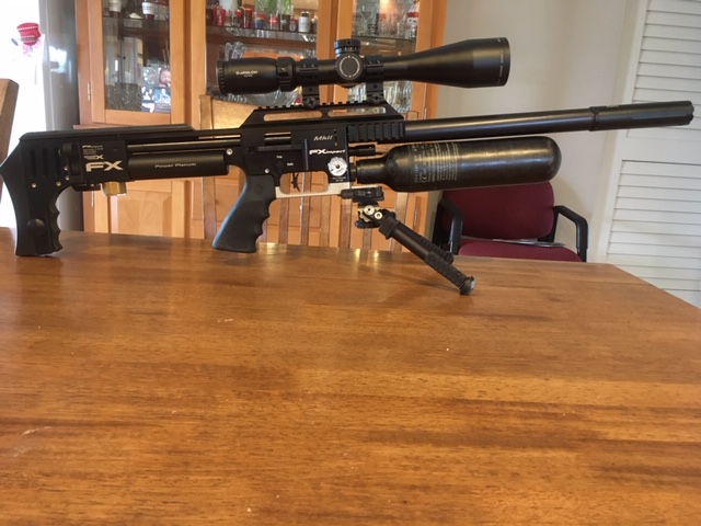

Im shooting .25 cal JSB 34gr 910fps with reg set @ 125 bar after backing off the hammer spring and valve stop to slow them down 25-30 fps and still getting 60 to 70 shots on reg depending on fill. Loving it!
MK2 600mm original S/T barrel
