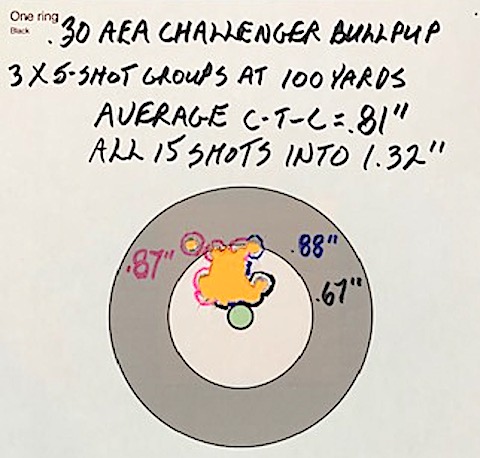

The most impressive accuracy results I've ever achieved with a pellet gun (happened to be a $500 Chinese-made PCP)-
