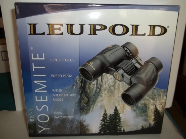

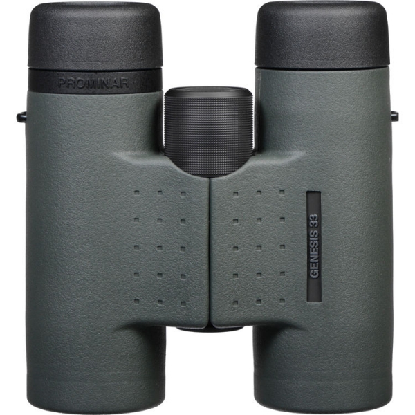

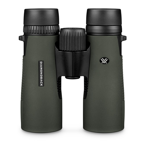

Prisms
Prisms are what let you see a correctly oriented image when you look through a pair of binoculars. There are two types of prisms in common use, Porro prisms and roof prisms.
Roof prisms are essentially in line inside the optical tubes, and make for a more compact set of binoculars. Roof prism binoculars have straight tubes (the front/objective lens is in line with the rear/ocular lens), and are therefore more compact, an important consideration for the sportsman. They usually have two pivot points between the tubes, and are more difficult to adjust to the spacing of your eyes. Roof prisms can give an optical image equal to the best Porro prisms, but for technical reasons they usually do not. To be really good, roof prism binoculars have to be in the high price class. Do not attempt to economize on roof prism binoculars.

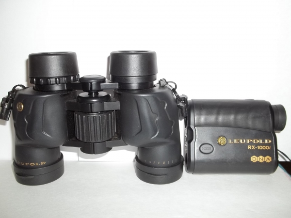

Porro prism binoculars can be identified by their offset tubes; the objective lens is not in line with the ocular lens. The front lenses are usually closer together than the rear lenses, but the reverse can also be true, particularly in compact models. The Porro prism design is usually optically superior to the roof prism design, especially in medium priced class binoculars. Porro prism binoculars have a single pivot between the two halves of the binocular, and are therefore easy to adjust for the distance between your eyes.
Like roof prisms, not all Porro prisms are created equal. BAK-4 prisms are the best; they are made of superior optical glass that produces clearer images. These are what you want in your binoculars. BK-7 prisms are also used, usually in lower priced binoculars. These are satisfactory, but they are inferior to the BAK-4 prisms. Some manufacturers will not tell you what kind of prisms they use, usually because they are of inferior quality.

How to focus binoculars
It is surprising how many people do not know how to focus binoculars correctly. There are two common focusing systems used in binoculars.
The first is individual eyepiece focus. This system is simple to understand, and easy to manufacture. It also lends itself well to sealed optical tubes, and thus is usually the focusing system used for waterproof binoculars. Individual eyepiece focus means that to focus the binoculars to your eyes, you simply focus the left eyepiece to your left eye and the right eyepiece to your right eye. There is no centrally located focusing mechanism. It is done like this. Look at something in the distance. Close the right eye (or cover the front of the right binocular), and focus the left eyepiece to your left eye. Close the left eye (or cover the front of the left binocular), and focus the right eyepiece to your right eye. You are finished, until you need to look at something at a different distance, in which case you need to repeat the process.
Because individual eyepiece focus is time-consuming, center focus is more common. Unfortunately, very few people understand how to correctly use center focus binoculars. Here is how it is done. Aim your binoculars at something in the distance. Close the right eye (or cover the front of the right tube), and focus the left side of the binocular to your left eye using the center focus control, which is concentric with the pivot shaft between the binoculars. (Note: the left eyepiece itself does not focus on center focus binoculars.) Next, close your left eye (or cover the front of the left tube), and focus the right eyepiece to your right eye. DO NOT touch the center focus control while you are focusing the right eyepiece to your right eye. Now you are finished. What you have just done is adjust the binoculars for your individual eyes. (Practically everybody's left and right eyes are different.) From now on, you only need to adjust the center focus control when you look at things at different distances. Center focus is faster and easier to use than individual eyepiece focus, once you have initially set the binoculars for your eyes.
