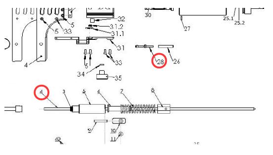

I am very much ready (in my mind) to start a heavy porting upgrade but I want to make sure that I have spare parts in my drawers.

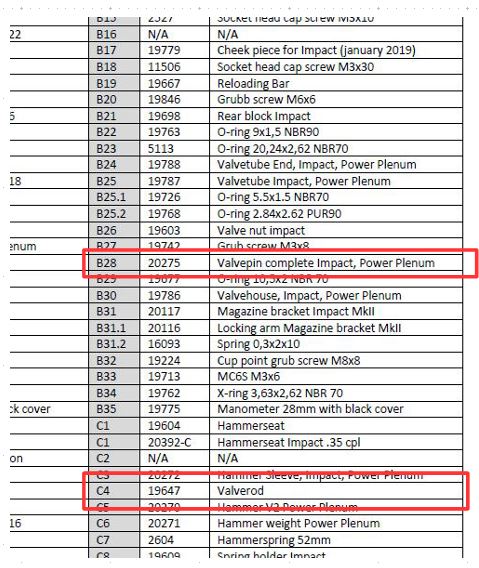

I have a full Impact oring kit in NBR90 from oringsandmore, only missing this one on the vale pin end, What is this oring size not listed in the BOM?
The other thing I am finding interesting, we are closing the 2020 soon and the Impact pdf BOM (revision 20.05) is still creating a mess wherever I go.
Lets take a look for example this valve seal. I just want to make a new peek poppet for a bigger port, really doesn't matter if I could get a pin only or the entire rod kit.
PN 20275 which is as per FX pdf the B28 the valve pin only, but the europeairguns ( Price: 35.75 € ) and bagnallandkirkwood ( £47.93 ) showing the same PN as an entire rod kit.

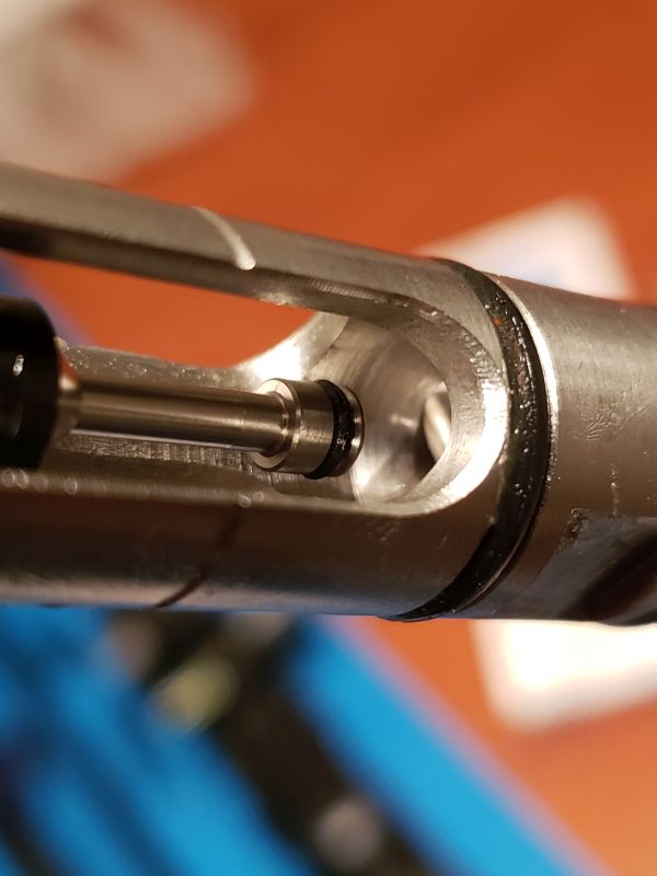

Here is another issue , way need to take into consideration. When you see the Valve stem flushing out into the Magazine side and not allowing the mag to seat, like the one below,
Then you need to check the B-28 Valve seat derlin ( black ) above the conical funnel shape seat on the rod. In my FX , its really damaged by 1 mm ( squeezed in ) and that was the reason to have the Rod pushing our of the valve assembly
