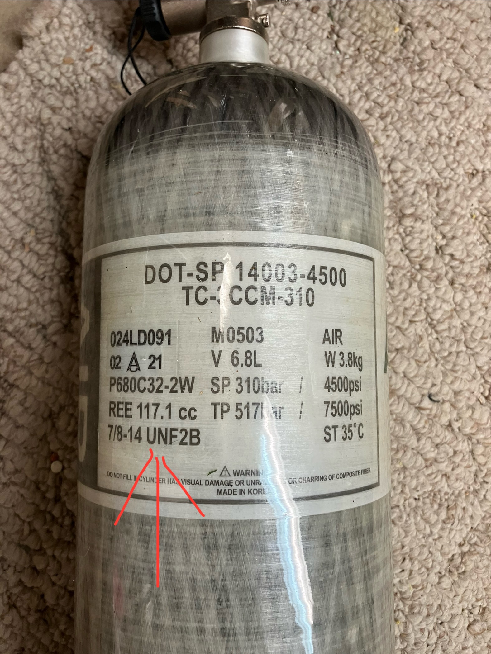

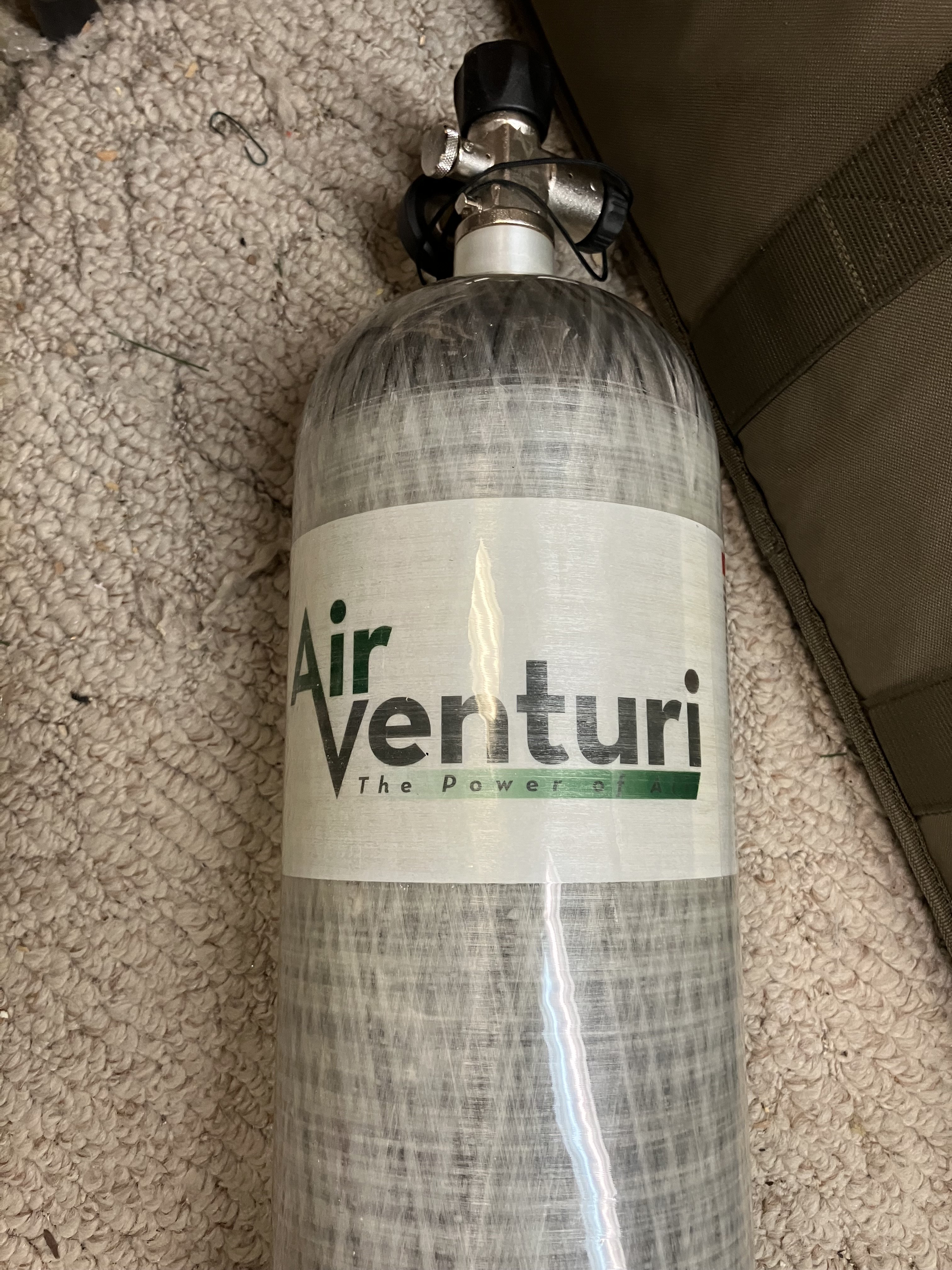

What is the thread size for top tank valve on my Air Venture 78 ci tank?
This is my AV 74CF tank label.

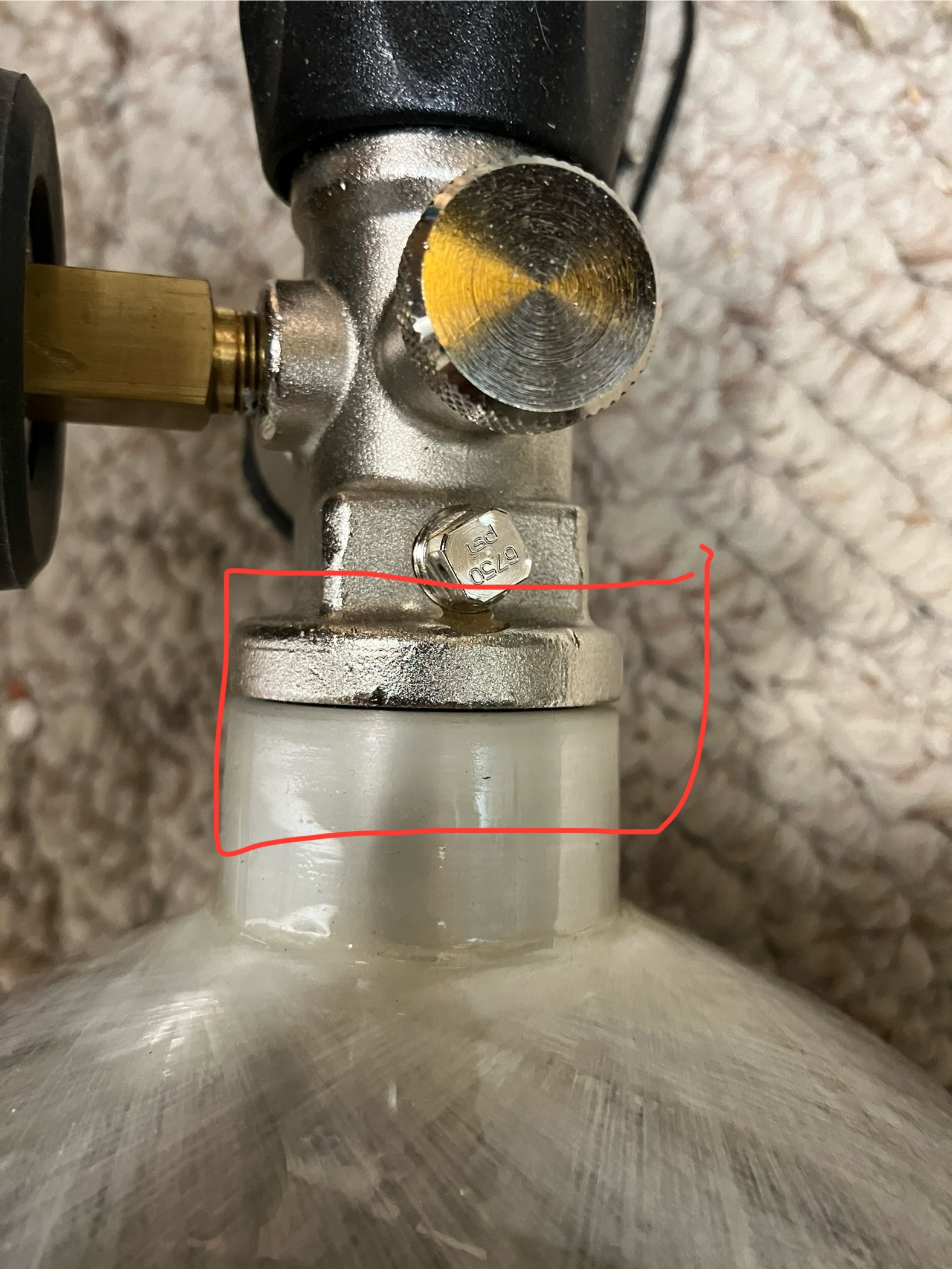

You do not. There wil be an O ring on the valve. It doesn’t hurt to put some silicone grease on the O ring. But just enough to make it shiny, not gobs. In the scuba industry we also put a very light coating of silicone grease on threads to prevent galvanic corrosion. Just a very light brushed on, again, not gobbed on. If you elect not to silicone them it would not be a big deal. Screw valve into tank and just turn till you feel it hard stop, that’s it, O ring does the rest of the job. There should not be any gap between the tank and valve. See photo.
