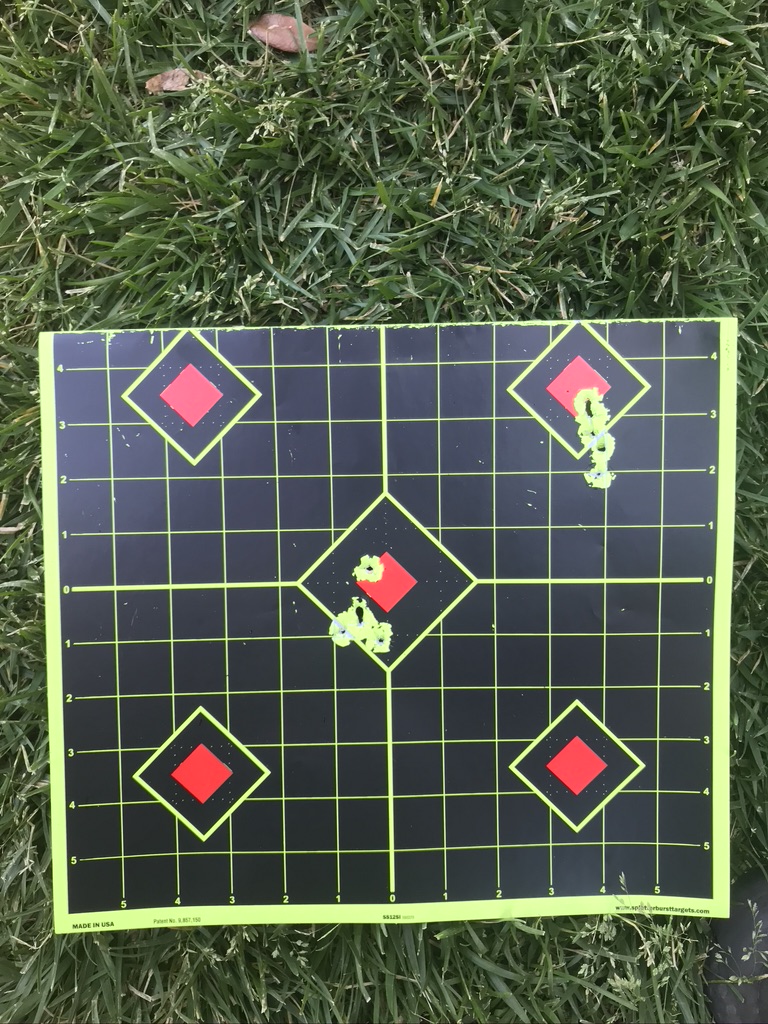

Hi Thomasair, It's a logical question indeed. I received a new FX Impact Friday and the first thing I did was shoot groups at 50. Hole on hole. That made me very happy. What's the next thing I did? Moved out to 100. I know It's not logical to expect 18gr pellets to shoot sub MOA at that distance for all the reasons you've stated- I agree. It's just a number ingrained in my head from all the years at the range shooting powder burners I guess. But maybe more to your question, I just find it "fun". Here's the first 2) 5 shot groups at 100 with unsorted JSB and it's pretty much like you said it would be-. I'm sure I'll continue to "chase" that sub-MOA group, just for the "fun of it"
