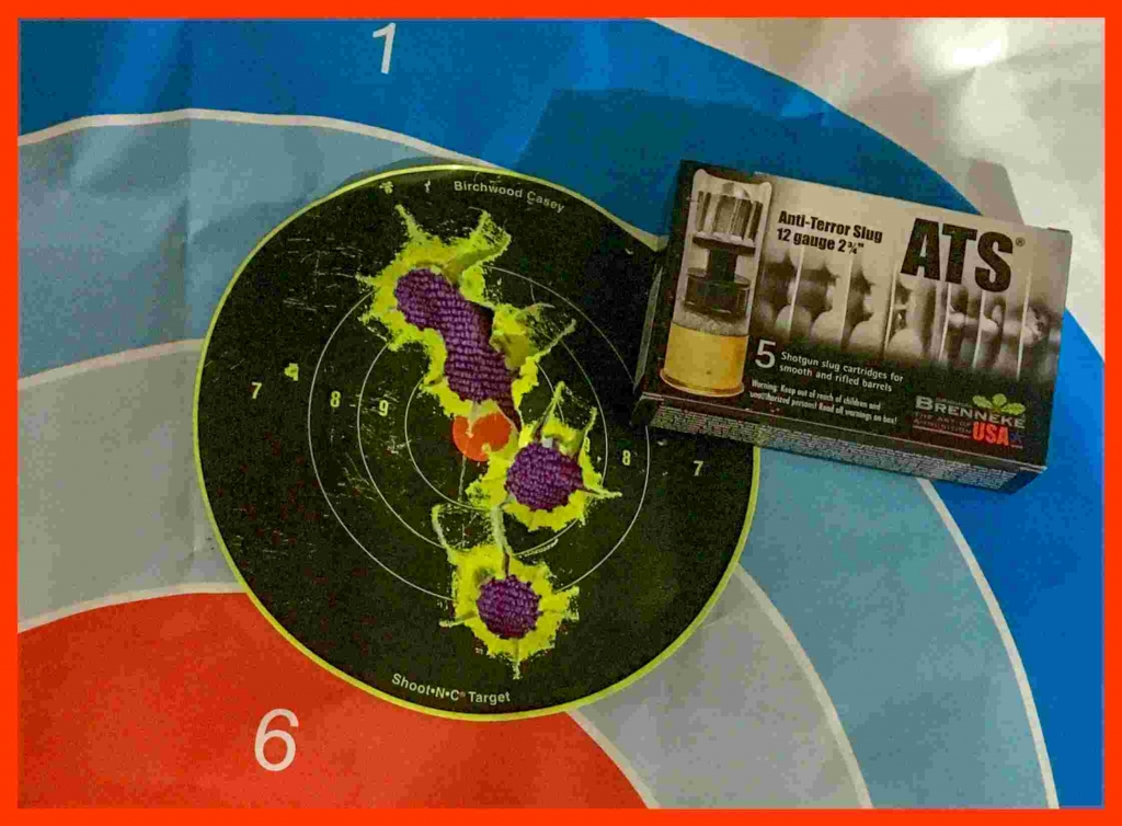

My new arm shoots 1 ounce at 1650fps at 2600fpe:
1555423402_14872915055cb5e0aa806ad9.54902840_C7D684A1-5283-4996-8016-B9D3A8866F06.jpeg
At 15 yards, offhand..🤠
