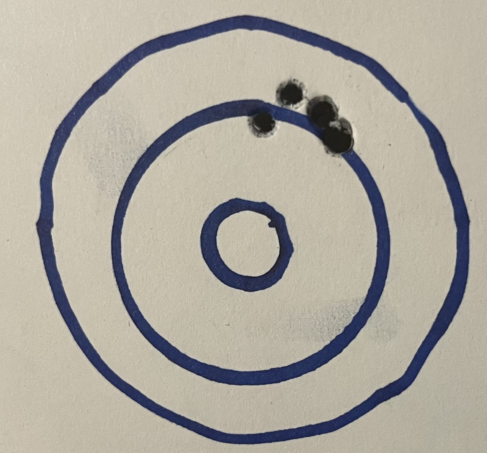

I have had pretty good success shooting various NSA Slugs out of my Air Arms S510 Tactical. For whatever reason, this one came from PA shooting HOT (around 27 FPE in .177!). The 12.5gr NSA's are singing along around 920 or so and they will consistently shoot around 1.5" or so at 100.

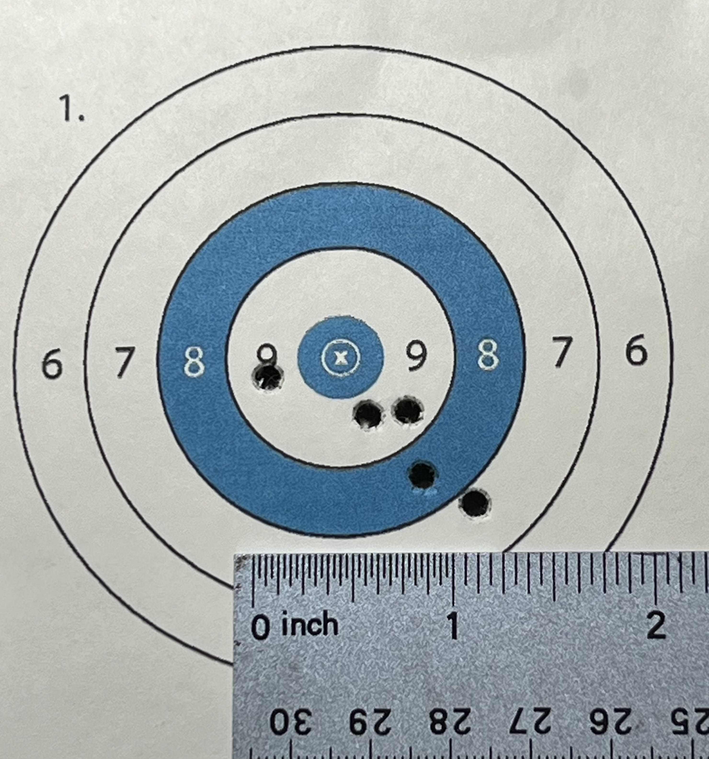

Several of the above posts have detailed good and bad about 100 yard 177 shooting. I plink a lot at various ranges up to 208 on my range and would not depend on any 177 except with the heavier slugs at longer ranges. I shot this at 100 with a 12 ft lb Steyr and 8.4 gn pellets in virtually no wind. The first 3 are touching but I could register the faintest change and held a little but still went left. On the fifth, I could feel just the slightest more change and held about 1" more and still went more left. It's a very good group and if the wind hadn't changed, would likely be all touching. To be clear here, the wind was so low, even with the felt change, didn't move my wind flag ribbons at all !
Now that was at 12 ft lb. The problem I've had has been stability. My wifes Red Wolf would likely do this in good conditions with 16.1s at 33 ft lb but they seem to go unstable somewhere around 85 yards. It can get sub moa for a lot of the shots but the ones that fly are really bad. These represent to me the best long range option because they are heavier and the best bc... just can't get them stable for that kind of distances. Now I've seen 10.3s and 13.4 MRD's stay stable much further but they blow a lot more in the wind so they are MUCH more difficult and critical to judge wind with.
All I'm trying to portray here is that though the 177 CAN shoot in really good conditions @ 100, trying to do that in any kind of wind will be quite difficult. It's already difficult enough with pellets that are twice the bc !

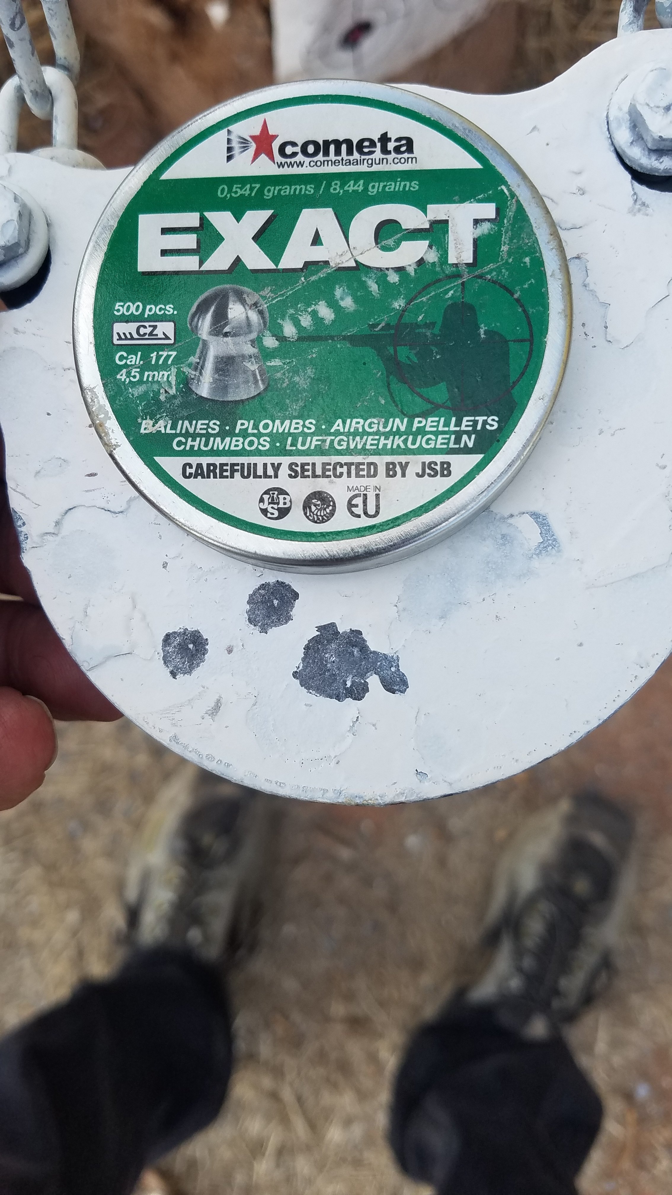

I have on the occasion of a calm day shot 2-1/4" groups at 100 yards with my.22 BRCK Sniper, using 18gr jsb pellets. It was my first go at 100 yds and I posted the results here.
Just the other day I shot one of my FX Royale 22s at the same distance resting off my truck bed again shooting at a plastic beer bottle target at 100 yds hanging in a tree, very light breeze. I was able to hit it 11 of 12 times (full clip) more than once trying to get 12 for 12, and that includes the bottle swinging mildly at times from the breeze and from the previous hit. So pellets can work at 100 yds.
