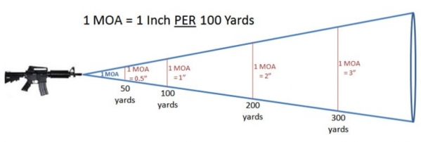

for me, more than 1 MOA is excessive, for general hunting purposes more than 2
Good is sub MOA accuracy

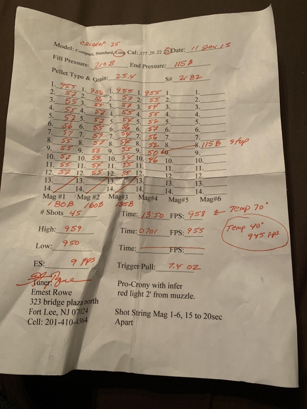

I've noticed that my Crickets almost always do under a 10 FPS ES, both in .22 and .25. That's with pellets straight from the tin. Here's one that Ernest did on a .25 Cricket bull pup I had a couple of years ago after a tune, using .25 JSB 25.4 grain Kings. It says 9, but I'd call it 7 FPS, since it came off the reg. a shot prior to being called. I also did a 40 shot string with my .22 Cricket mini last weekend, and had a high of 869, low of 863 FPS (and only one 869). 250 bar fill, stock regulator, pellets direct from tin (JSB 18.1 grain).
