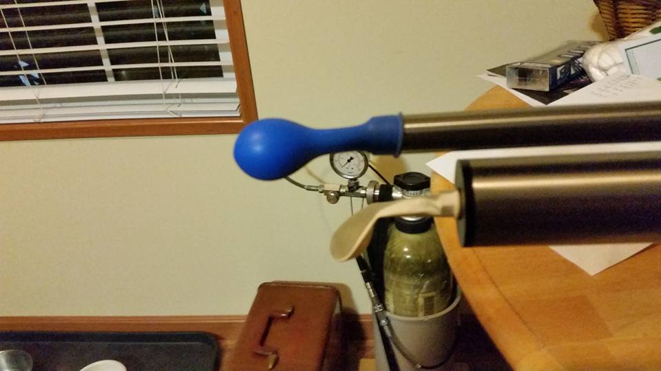

Check that no air is escaping through the firing valve out through the barrel.

I'd start by leaving a balloon over the end of the barrel for the night?
