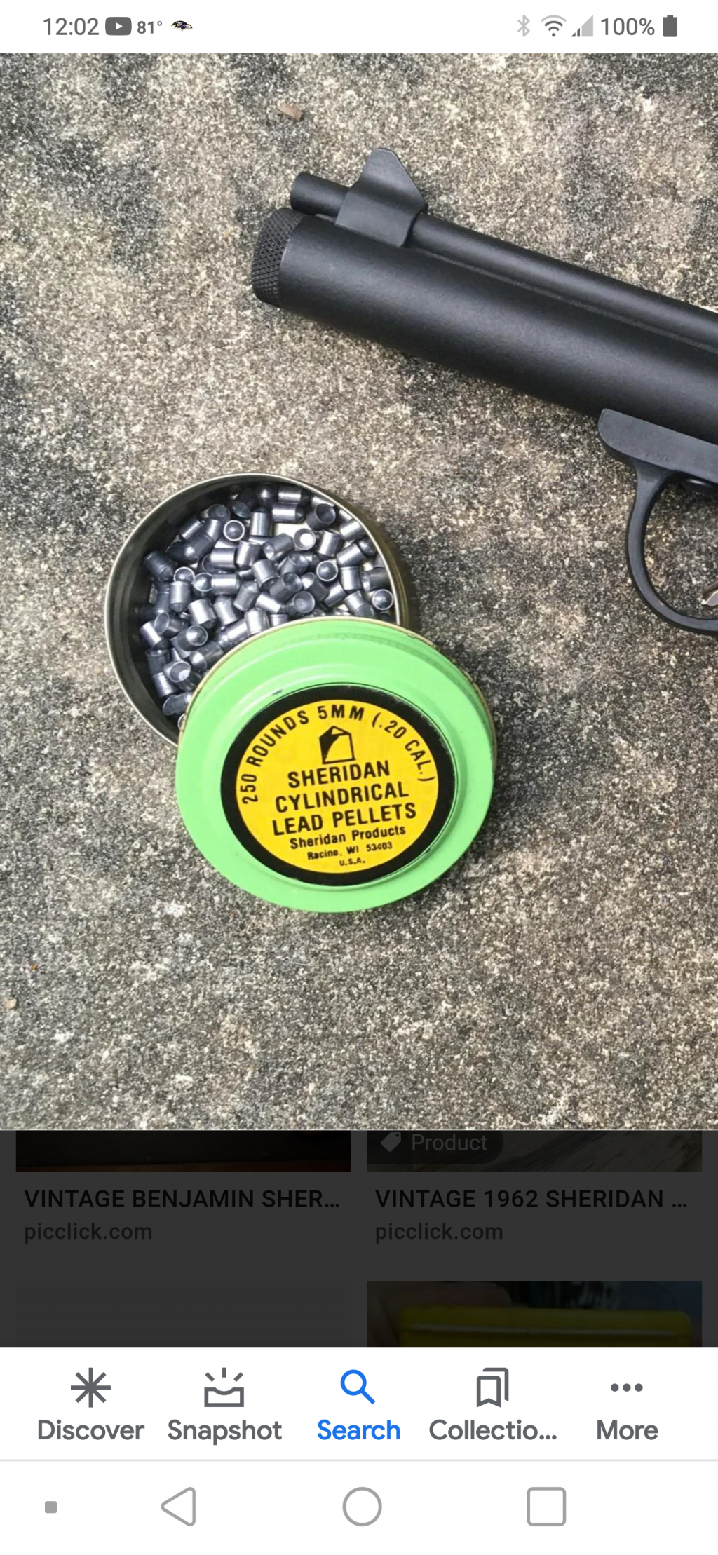

Some will argue but the old Sheridan. Were old of the first slug. A pellet it is not.
A slug is a traditional bullet shaped projectile solely dependent on the barrels rifling to stabilize it in flight.
