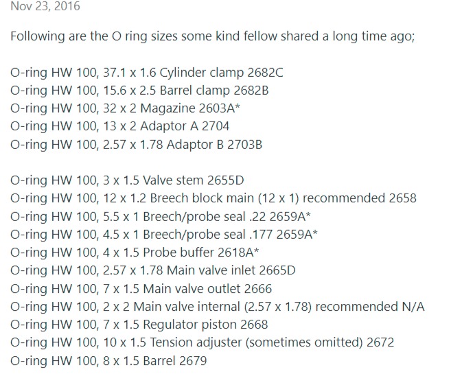

Is this an O-ring for the filling probe adapter or something else, can't find any info on this anywhere else. It appears the fill probe adapter o ring is a different o ring than the probe buffer o ring.
I see that the part number for the probe buffer o-ring is listed as 2618A*

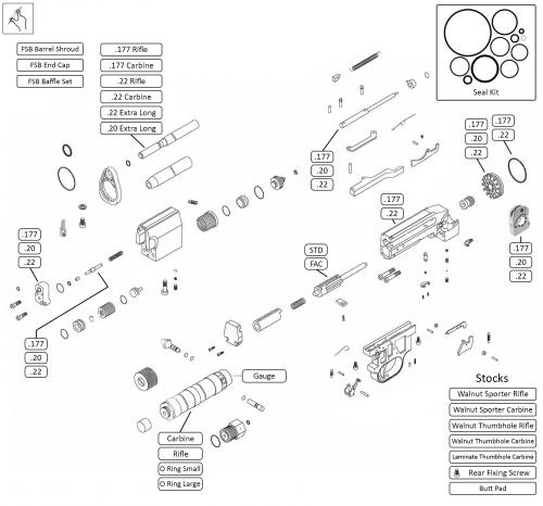

I don't see a "Probe Buffer" listed in this picture.

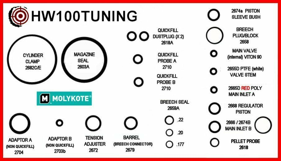

See if the rubber diameter and the overall diameter is the same as the "Fill Probe" o-rings. If they are...
You need two for the fill probe, right ?
