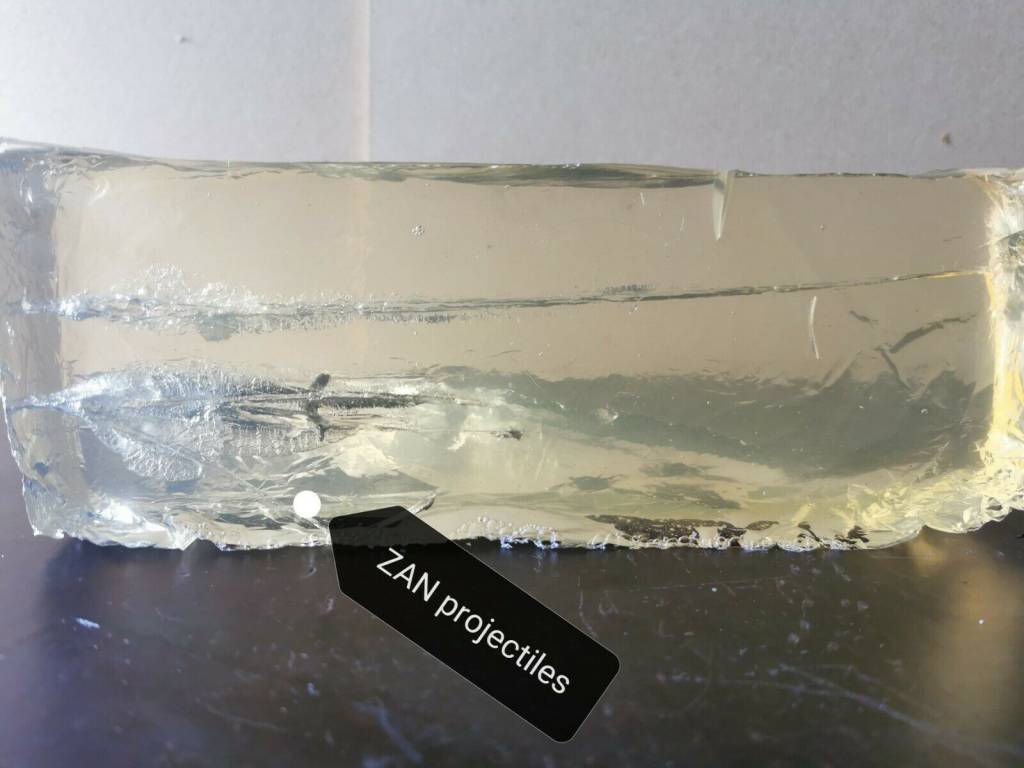

Hollow points slugs have been designed to open up at a certain fps, I wonder if the slower speeds allow the hollow point to do it's thing or stay together, no point to using them if they don't open up.
They do open up good. I did some slow mo in my upcoming video. They destroy fruit. I'll tell you that.
