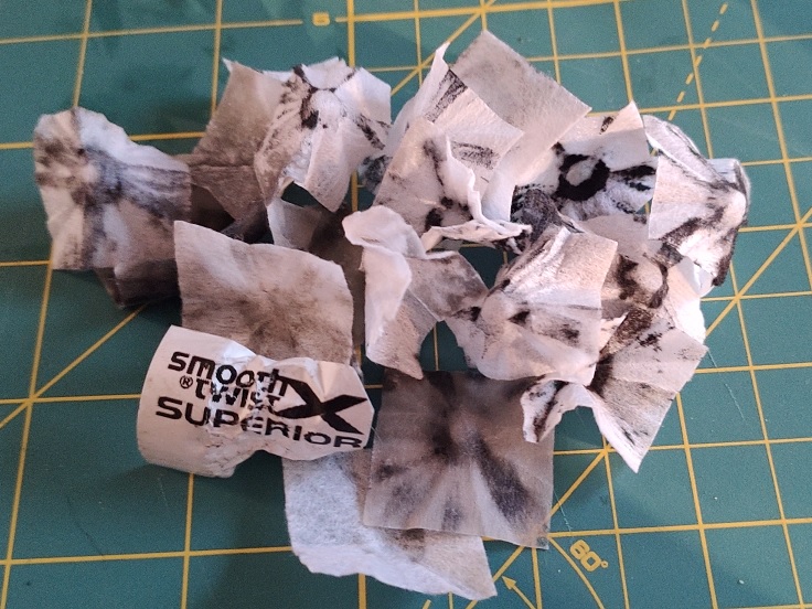

I then found my missing FX barrel sticker, it must have come off inside the barrel and then gotten jammed deep down behind the carbon fiber tube, but the sticker do read Smooth twist X superior, so there should be a chance of the gun being able to drive in tacks.
Also ran a lot more patches thru the barrel and again they came out really black at least for starters, so now i am ready for my #3 go at shooting my fine mew Maverick, and hopefully this time it will perform more to my expectations, for the next shoot i will also be the owner of a crono so i will be able to take a more scientific approach to my shooting, maybe change the REG setting away from the default 90 BAR

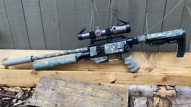

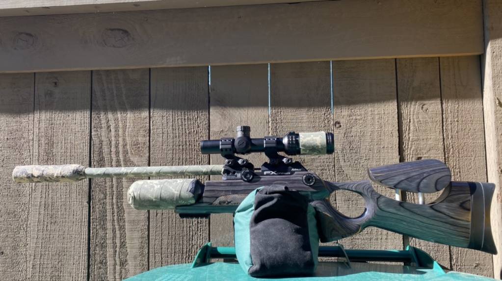

Then I was wondering about which scope to use, wanted to drop a bit more weight especially on top so for fun I put on my Alpha6 1-6 LPVO scope. Now it’s a Crown Ultra Compact CQB edition! 🤣
as you can see in picture it balances very well!
Think I will try to tune it for 10FPE on min power with TP on medium and 6.5 FPE with TP on low, then see if I can get it to shoot 12.5 grain slugs at 750fps on high power. Will have to tinker with it more at the range.

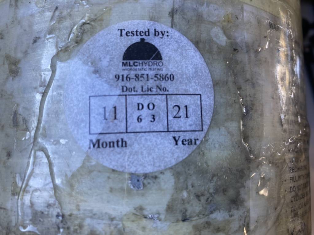

Picked my 45 minute tank/bottle from hydro testing yesterday. Trying to fill the tank this morning with my compressor and thinking to myself I really should just have the paint ball shop do the initial fill. On my second run and cool down cycle and I’m barely at 2000 psi. 😭
EDIT: as I try to fill the tank my YH compressor gauge gave up the ghost. Doh!
