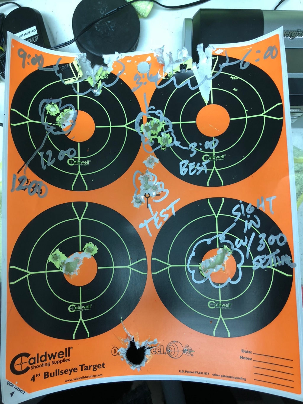

Max, thanks for posting this. Perfect timing as I was going to go thru the final sight in of my wildcat 25 cal MK2 today. CHUCK had explained all of this in detail to me, but I’m a visual guy and your video helped. Indeed it was an interesting test. I was getting accurate, but clover leaf groups, and I wanted to at least see more if not all shots being hole in hole. I understand pulling the shot, and I know when I do that. So today I went thru your procedure, and here’s a pic-
12:00 was the start, and you can see at top left target I’m just to the left of the bullls. Rotated it to 3:00 and the group got better, and that’s it to the right, just outside of the top left target. Rotated it to 6, and the V shaped cut at the very top of the top right target shows it. Finally at 9 I hit the V shaped cut above the top left target.
rotated it back to 3, aim point is the bullseye at bottom left, and that big hole at the bottom is three shots. Weird how it would now appear there, lol

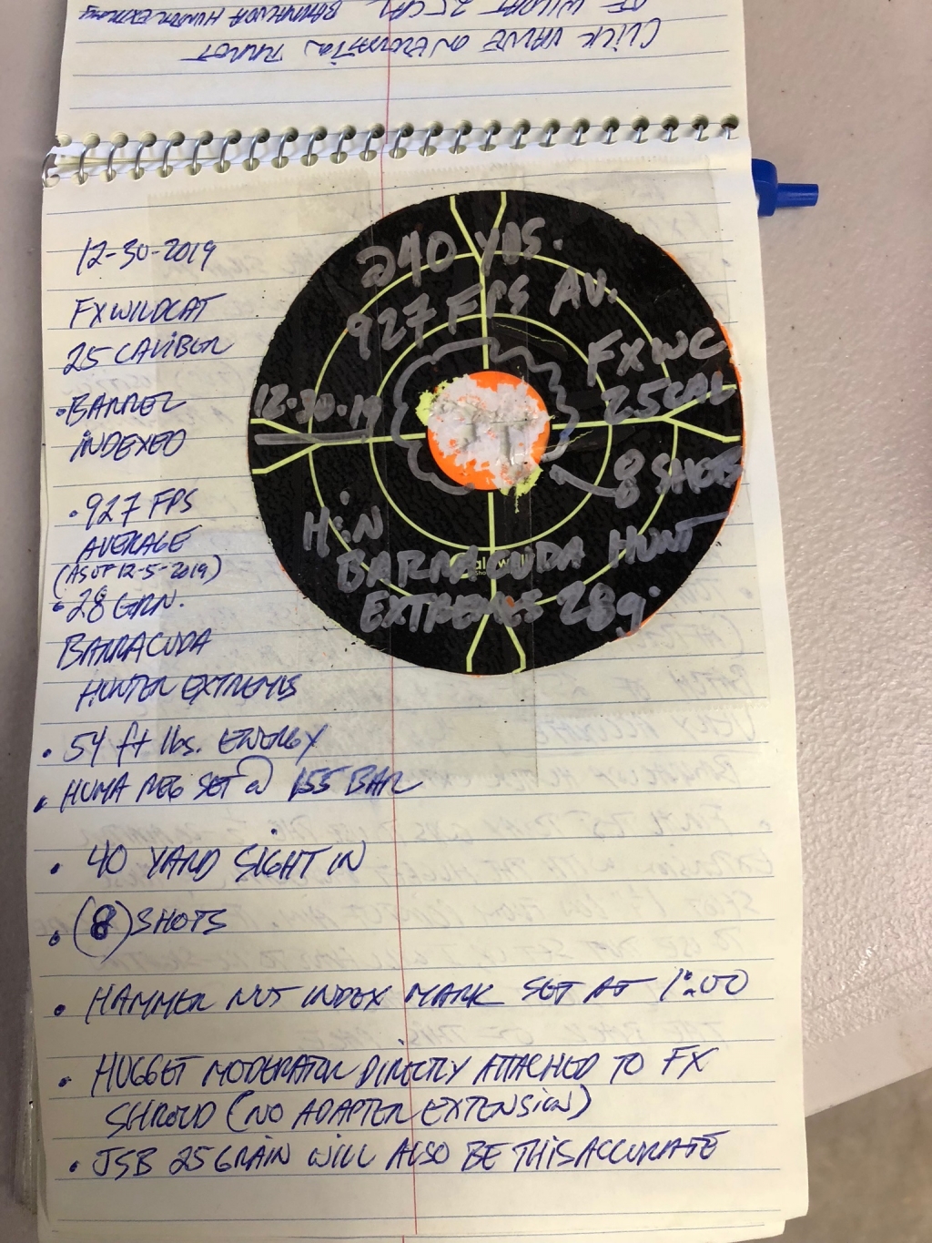

After a bit of fiddling around, I am stopping with this as my final sight in, 40 yards, 8 shots total, or one mag. So I’m good. It was a good learning experience, and among other things I learned was just how a bit of a change on the barrel shroud affects accuracy. In your video you shot without the shroud, while I replaced mine along with the moderator at every test. After I was all sighted in I installed the typical 1/2-20 adapter that’s about 2” long, and changed out my Hugget end to 1/2-20 to now thread onto the shroud, whereas before I had the FX thread end cap on my Hugget and threaded that only to the shroud, making the barrel more compact. My shots were a bit spread out, and almost two inches higher with that extra length adapter. I didn’t think that would’ve affected POI that much.

@bigragu. I am glad you find the video useful. I am just passing on information I learned from AGN to fellow members so we can all share and learn together. Good grouping you got there. Yes the LDC will change the POI somewhat, but as long as your barrel is in the right location where it is shooting the best group then all is good. you just need to fine tune with your turrets to make the adjustments.
