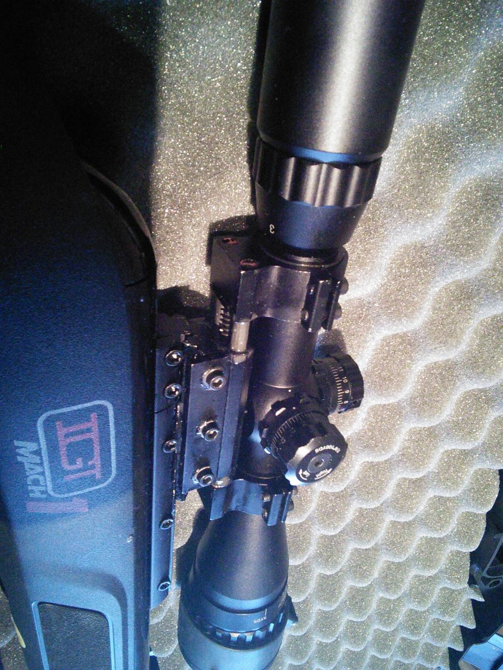

I keep meaning to get one of these. Guess I fear I'll get a lemon and it'll frustrate the heck out of me.
Got 4 of them on my IGT springers. No lemons but apply the blue threadlocker. The pins sometimes have a little give, however without impacting accuracy. Grease them with heavy industrial lubricant. Place a few o-rings to act as buffers to dampen the stopping sounds. Most important of all, mount them in the right direction. Dual recoil is a strangely unforgiving thing. 🐦
If you spent a lot of money on the scope, and it breaks, you move on to PCP. At least that appears to be the trend that I have seen in the past couple of years. It gets tiresome to always have to deal with the reverse recoil issue after a couple of decades, at least it did for me. But, there are ways to deal with it, as already mentioned. Buy full warranty scopes and hope for the best at the very least.
