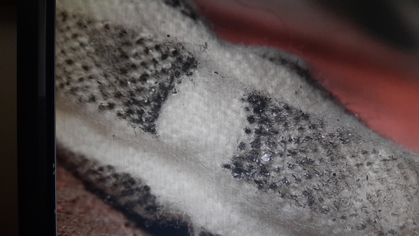

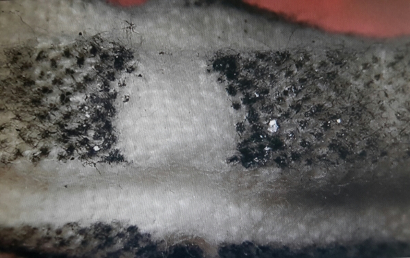

As some of you probably know, I thoroughly clean, weigh, and lube my .25 cal. JSB 34gr. Heavy's with Napier Pellet Lube. I shoot several cans of pellets through my Wildcat MKI and former Streamline until I perceive a change in accuracy. At that point I run a dry patch through the barrel a couple times and it only shows a little color. But after the dry patch my accuracy comes right back where it should be.
