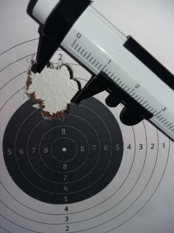

What gun will shoot 1 hole groups at 50 yards?
This is 50y group made with my Vulcan Tactic .25. 1/2in but very respectable for a 9 shoots.
