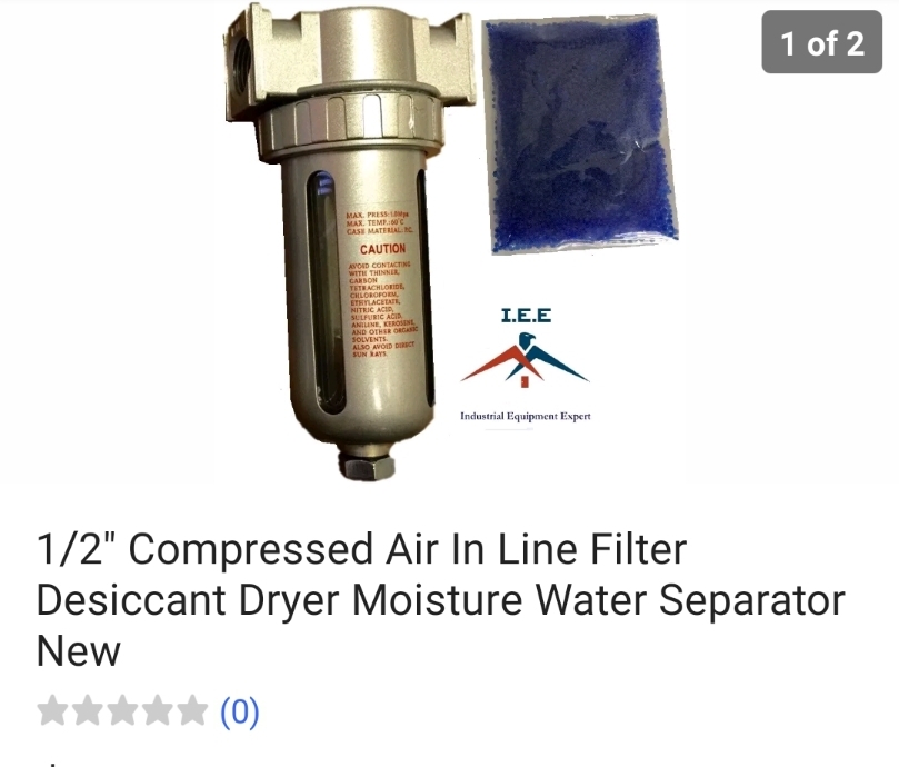

I went with one of these.
Doesn't look like rated for 4500 psi ......
It's not, that one goes on the input. With the SB it is easier to filter the air "prior" to compression.
Correct this goes before the showbox. This one is only rated for 150psi. So I'm filtering the air coming in from my compressor to the sb.

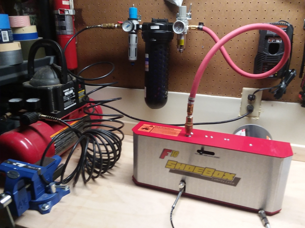

Here's the setup that I use for my shoebox. I have a new shop compressor not shown in the pic that runs at 125 psi into 5 micro filter/water separator. Then I use the big Wilkerson desiccant filter, followed by another 5 micron filter/ regulator.
Most of the water that's in the air is squeezed out in the shop compressor as its pumped to 125 psi. The big Wilkerson desiccant filter does a great job treating what moisture is left. You can typically pic these up on Ebay for around $100. I do regenerate the beads a few times a year. I haven't noticed any signs of water at the output of the shoebox. Also to note that given the shoebox low flow rate, the water separators don't actually catch any water. They're in there primarily for sediment filtration prior to the shoebox. I considered a high pressure filter after the shoebox, but after over a years worth of running, I dont think it's necessary.
