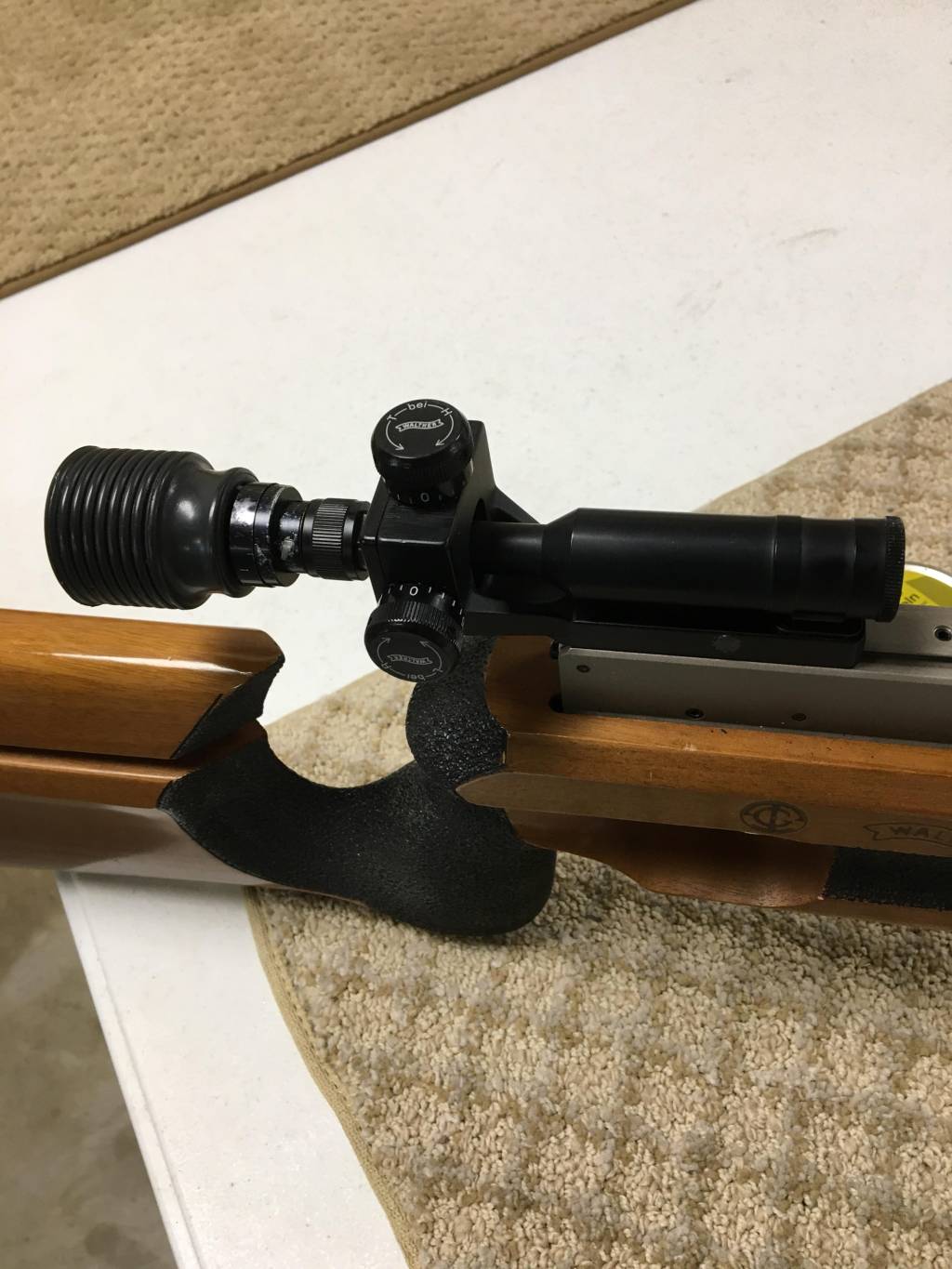

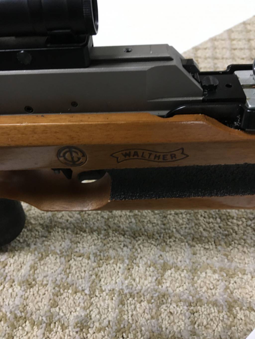

I recently had the opportunity to go to a club that shoot the steel shilouttes at 10 meters indoors, all offhand. Rams, pigs, turkeys and chickens. I shot a borrowed Walther CG90 with a non magnifying optic target scope. This better simulates the size of KZ (actually smaller) I’m shooting at in HFT. I averaged better than 70% both matches so if I can convert this percentage to standing FT my position in finishing might go up a few.

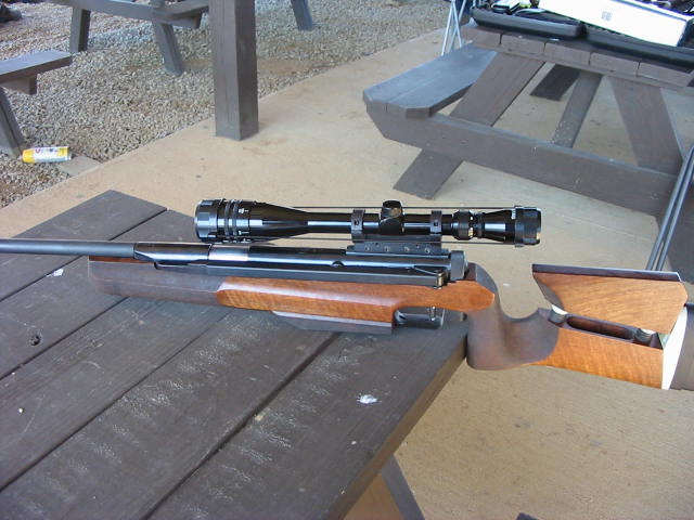

Typically, The term “10 meter shooting” implies shooting like they do in the Olympics etc., meaning offhand with diopter sights at bullseye targets fromm10 meters.
Years ago I was surprised to see skilled, ranked 10M shooters do only fair at airgun Silhouette and Field Target events. These shooters opined the main problems were they had fired hundreds of thousands of shots at targets roughly the same height as the gun, and they were used to targets of an exact size, shape, and distance … a black circle on a leveled, square white background, and had built up “muscle memory”.
For FT offhand practice, its best to use a scope with similar reticle and magnification (don’t exceed 12X on close ones) you will use for matches. 10meter is fine, but try a dark background with and even darker target circle to simulate some tougher ones I’ve seen, and practice with the targets a foot or less above floor level. At 10M, a dime-sized circle is about right for practice. I prefer to come up into the target (rather than down as many bullseye shooter do), since I can see the target sooner, and (ideally), break the shot as soon as I’m into it, rather than bouncing back up.
