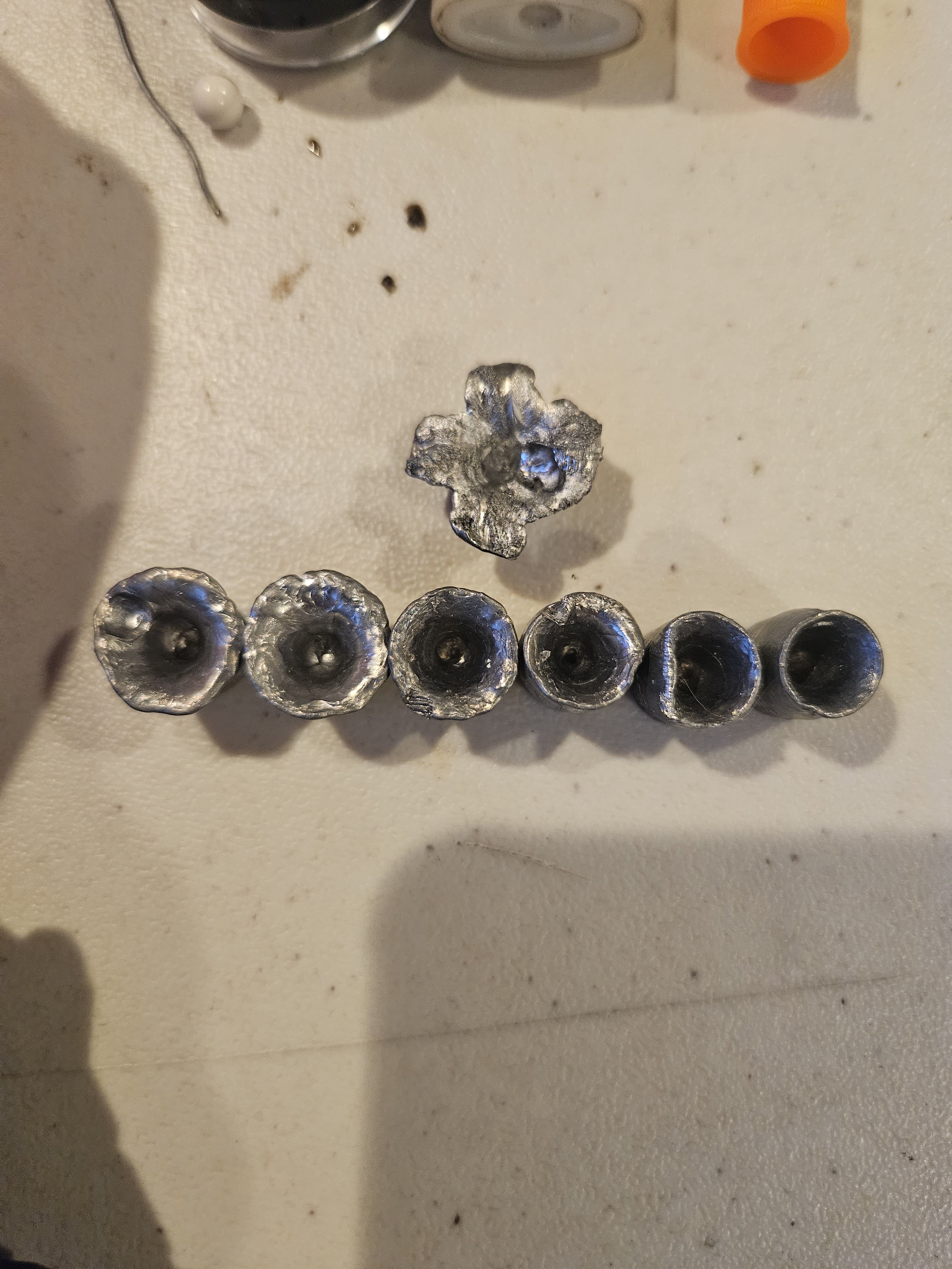

I did some testing with ballistic gel and the first shot kind of opens a hollow point but the next 5 don't really expand.
That's the shots in order from 1 to 6. The top one I cut the inside of the cavity with a dremel so it had score marks going from the base to the tip, it opened up way better. If a rabbid coyote is about to attack you it might leave a mark. :)
I have other guns I would use for serious hunting, the m50 is a really fun "toy" to play with imo.
