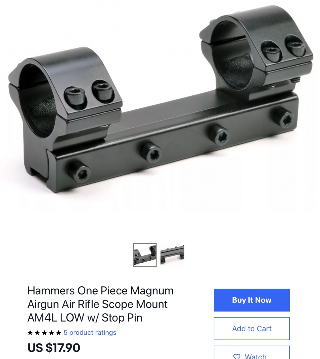

Use a one piece scope mount or an UTG dropper mount . It has four screws on the base to clamp to the11mm rail on the gun and convert it to a pica tinny rail. Then use proper size rings for your scope. ( low or medium ) that have the pica tinny base on them. I put this on my RWS 54 and RWS 56 that are known scope killers. They are magnum air rifles. The mounts work great.

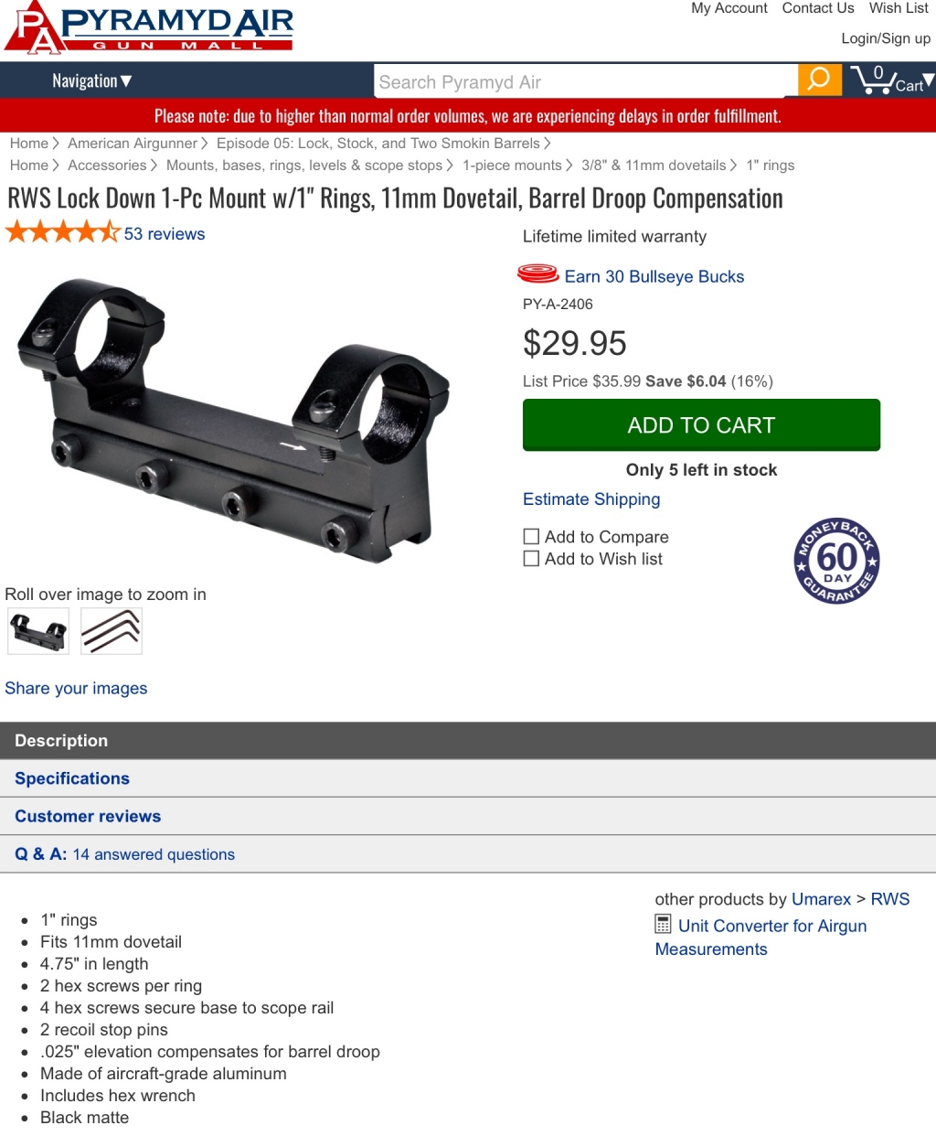

https://www.pyramydair.com/s/a/UTG_Drooper_Scope_Rail_11mm_to_Weaver_Adapter_Compensates_for_Droop_Stops_Scope_Shift/4191
UTG has many new to me scope mounts i see not the drooper it has been around and used for a very long time

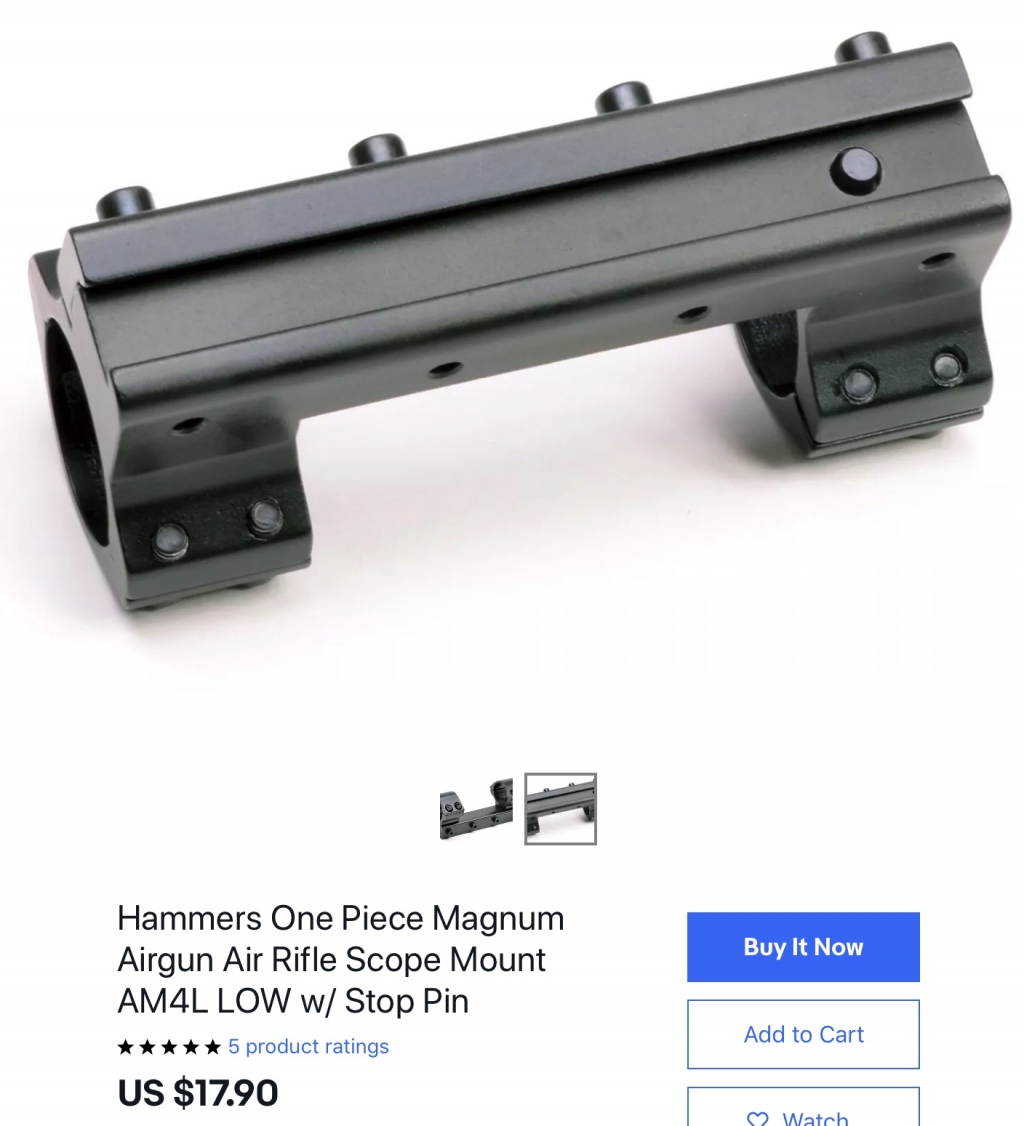

The pics show 4 screws to put more clamping force on rail plus a stop pin that can be screwed in rail.
the mounts with drooper gives scope better range of adjustment.Because pellets drop quick.
I like the UTG rail best more adjustability but raises your scope a little high.
