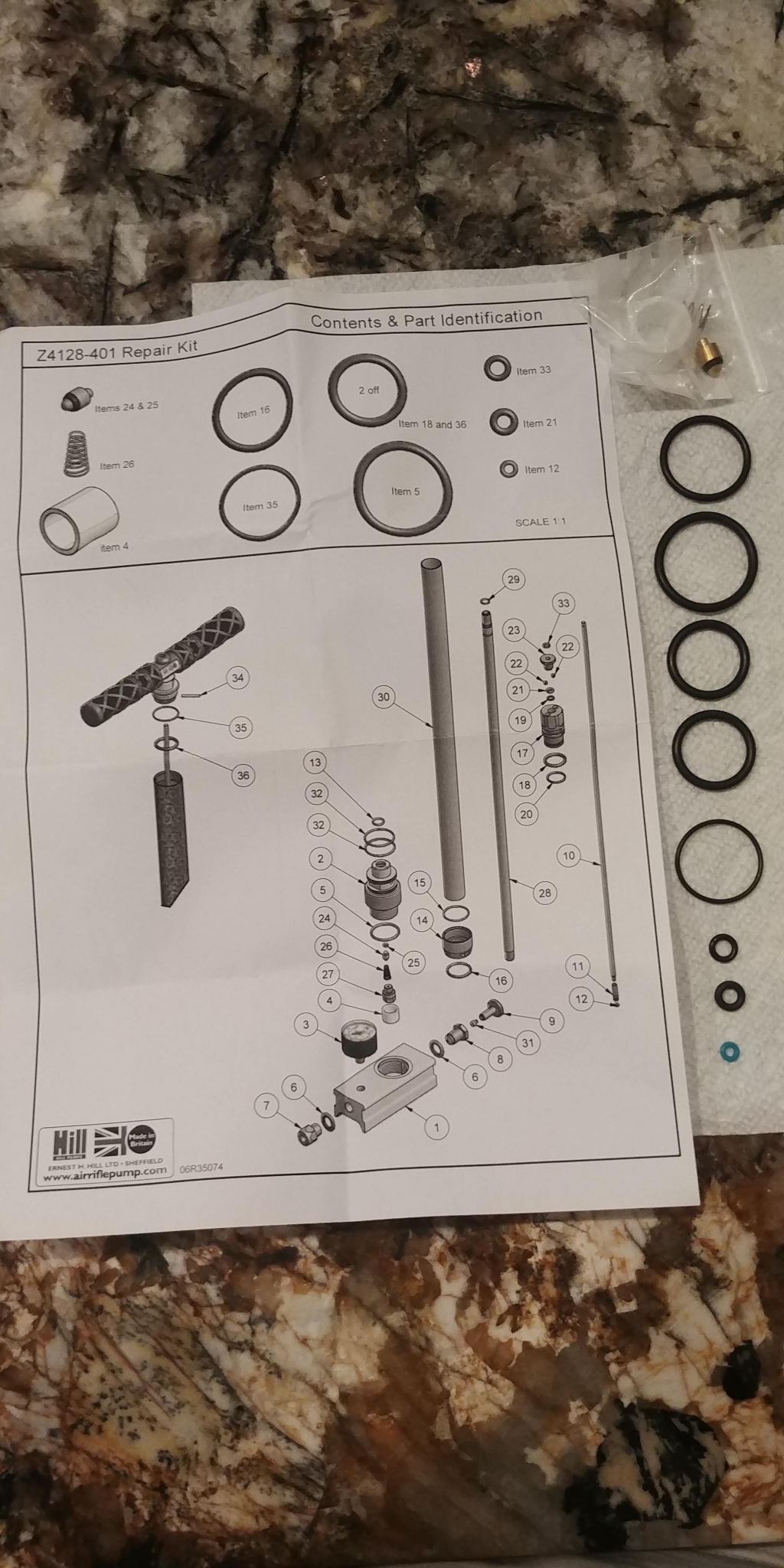

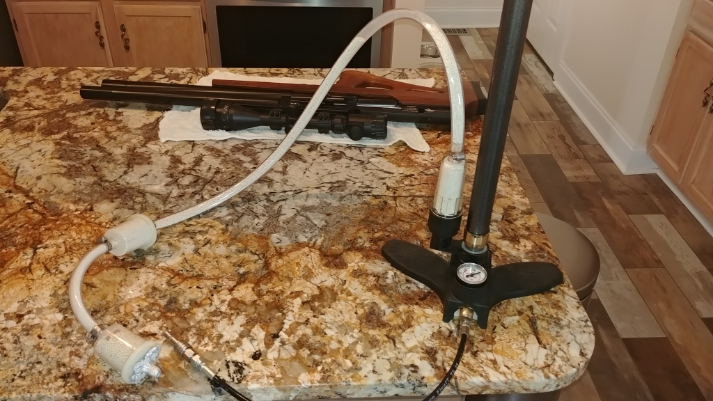

I have two Hill Mk4's and I use them most days to fill my seven PCP's, I pump a lot! I consider hand pumps "low" maintenance not "no" maintenance, pictured is a Hill Mk4 service kit, the o-rings are remarkably durable requiring replacement very infrequently however disassembly cleaning relubing I do every couple of months, this takes at least an hour or two, clean everything inside and out with alcohol clean the internal filter inspect the orings, I've learned that o-ring #18 & #12 are the ones that fail most, also during use keep silicone grease on the #30 tube surface, I've added additional moisture and "dirt" filters on my pumps. I highly recommend the Hill Mk4!
