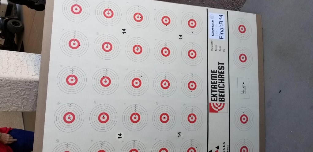

Here is a picture of my EBR card.
Centercut,
No that was my 5th shot and the one that made me mad. That was when I decided to shoot like I had been practicing and started to shoot better. The top line was the last line I shot: 10x; 10; 10; 8; 10.
