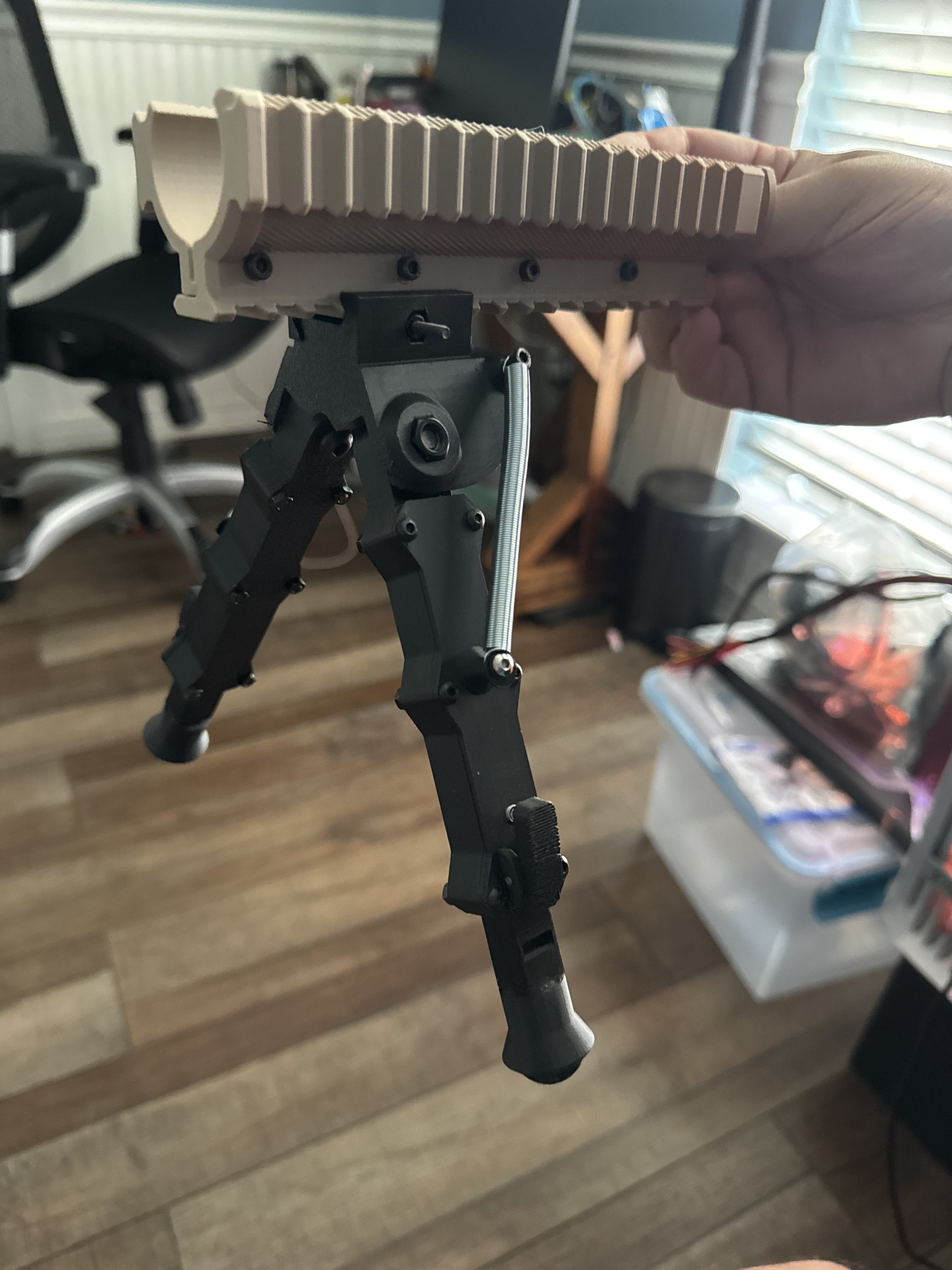

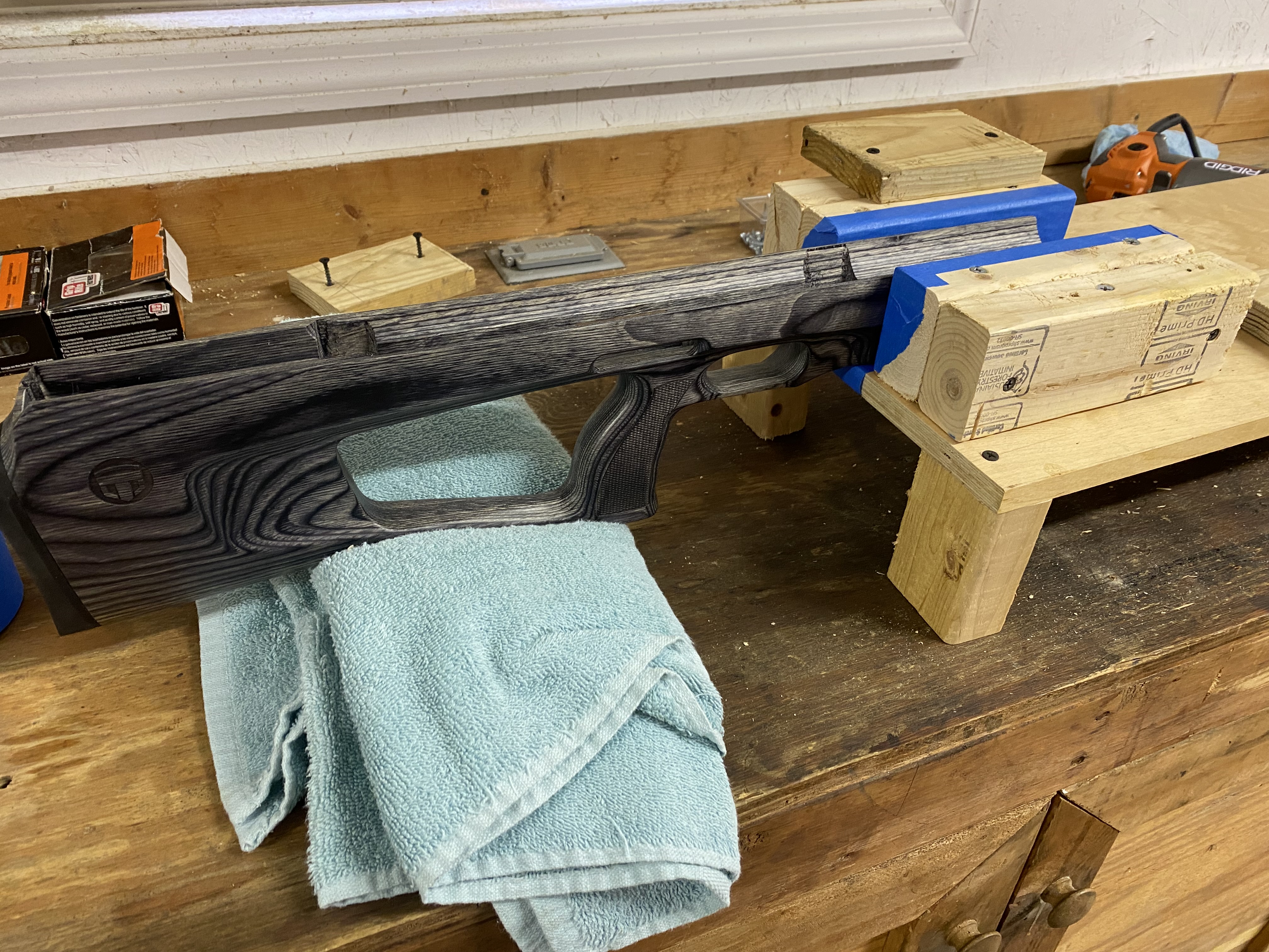

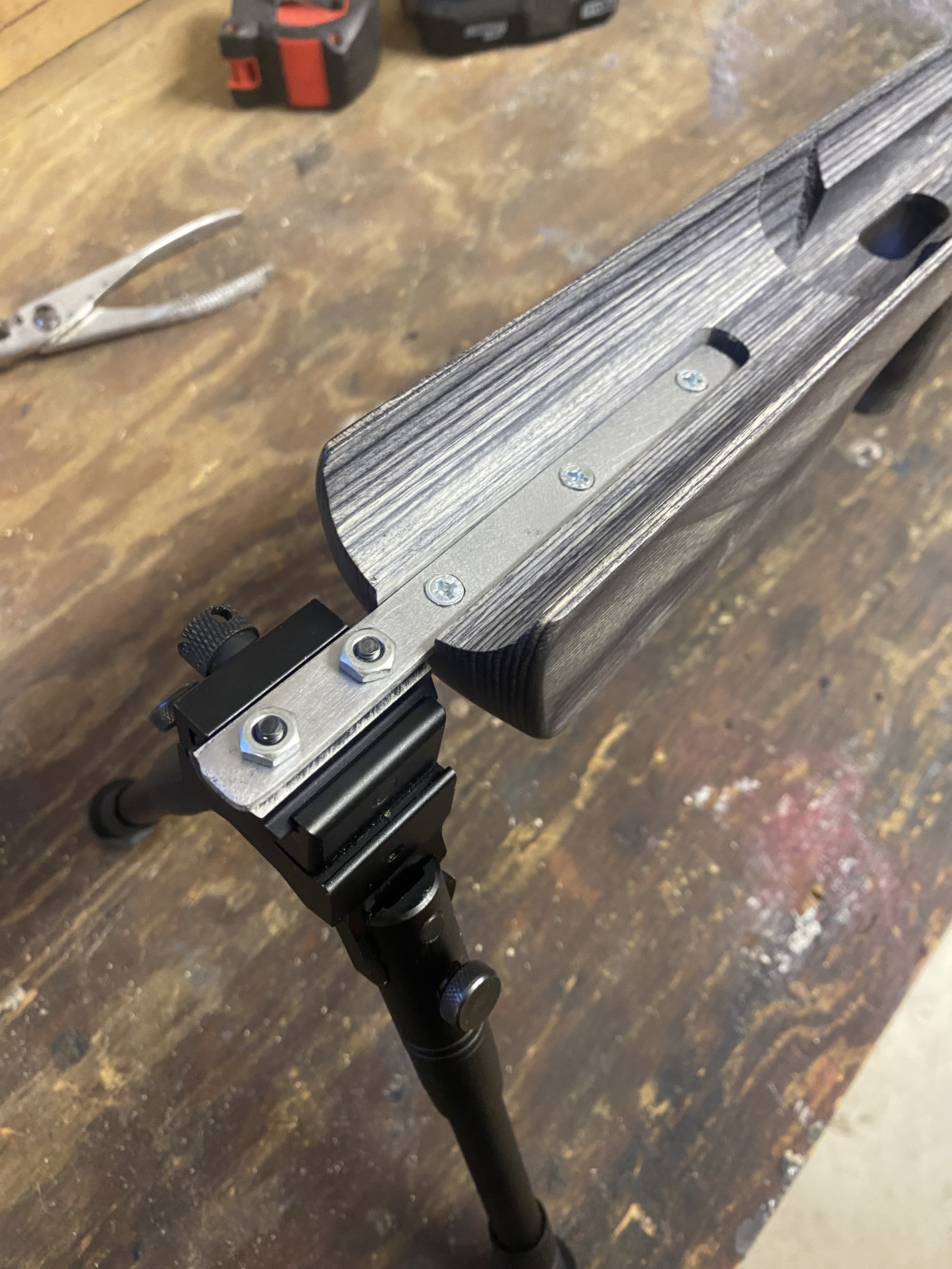

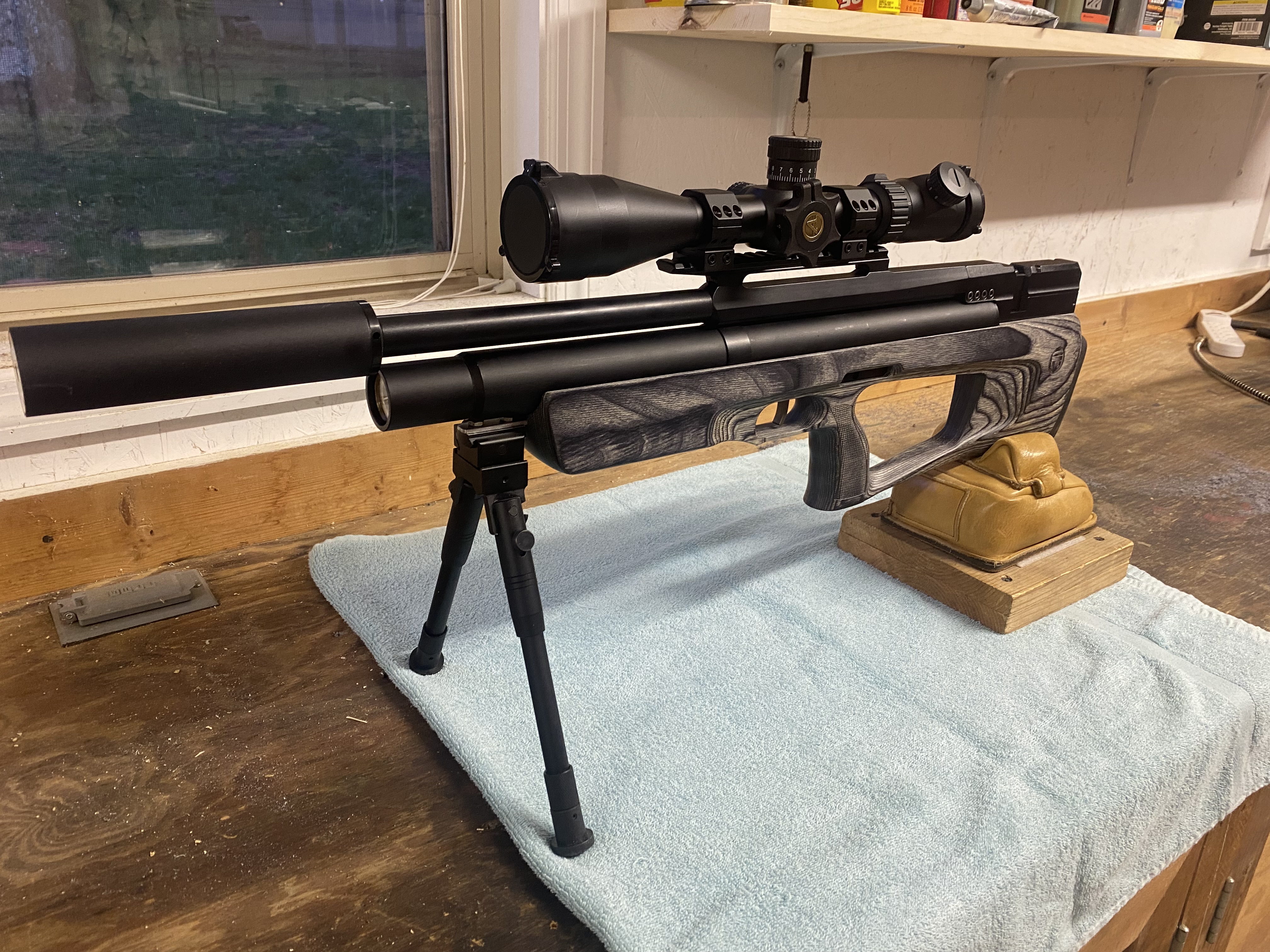

It was actually last night, but I mocked a bipod mount for my Taipan Vet 2. I also like to shoot it off of a bench rest set up, so I didn’t want to just screw a picatiny rail or a sling attachment to the stock where it would be in the way. I did the mock up using a piece of 1/2” wide x 1/8” thick piece of flat bar thst I had laying around and it’s a little springy. Now that I proved the concept, I have ordered some 1/2”x 1/2” and 1/2”x 5/8” aluminum bar stock. The homemade jig and a trim router did a great job of inletting the stock. View attachment 560396View attachment 560397View attachment 560399
That's looking mighty fine!

Thank you! Hopefully I get the aluminum bar this week, so I can finish it up next weekend. Now I just have to pick out a nice bipod. The one in the pic is a cheap UTG with a ton of slop in tne legs.
I'm rooting for ya bud, that could change the game for new taipan to come with your build!
