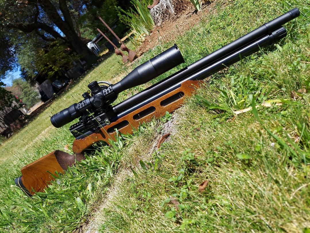

Decided that the JTS Airacuda .22 standard should have a regulator :rolleyes:
Happened to have an extra factory MAX regulator on hand, so fabricated an in-tube holder having a smallish plenum volume.
Set at @ 120bar filled tank to 3k and went about shooting 48 regulated shots ( JSB 15.9 @ 890 fps )
While not a power house, its running a healthy +28fpe being very quiet & accurate .. perfect for a hike around plinker / light hunter.
