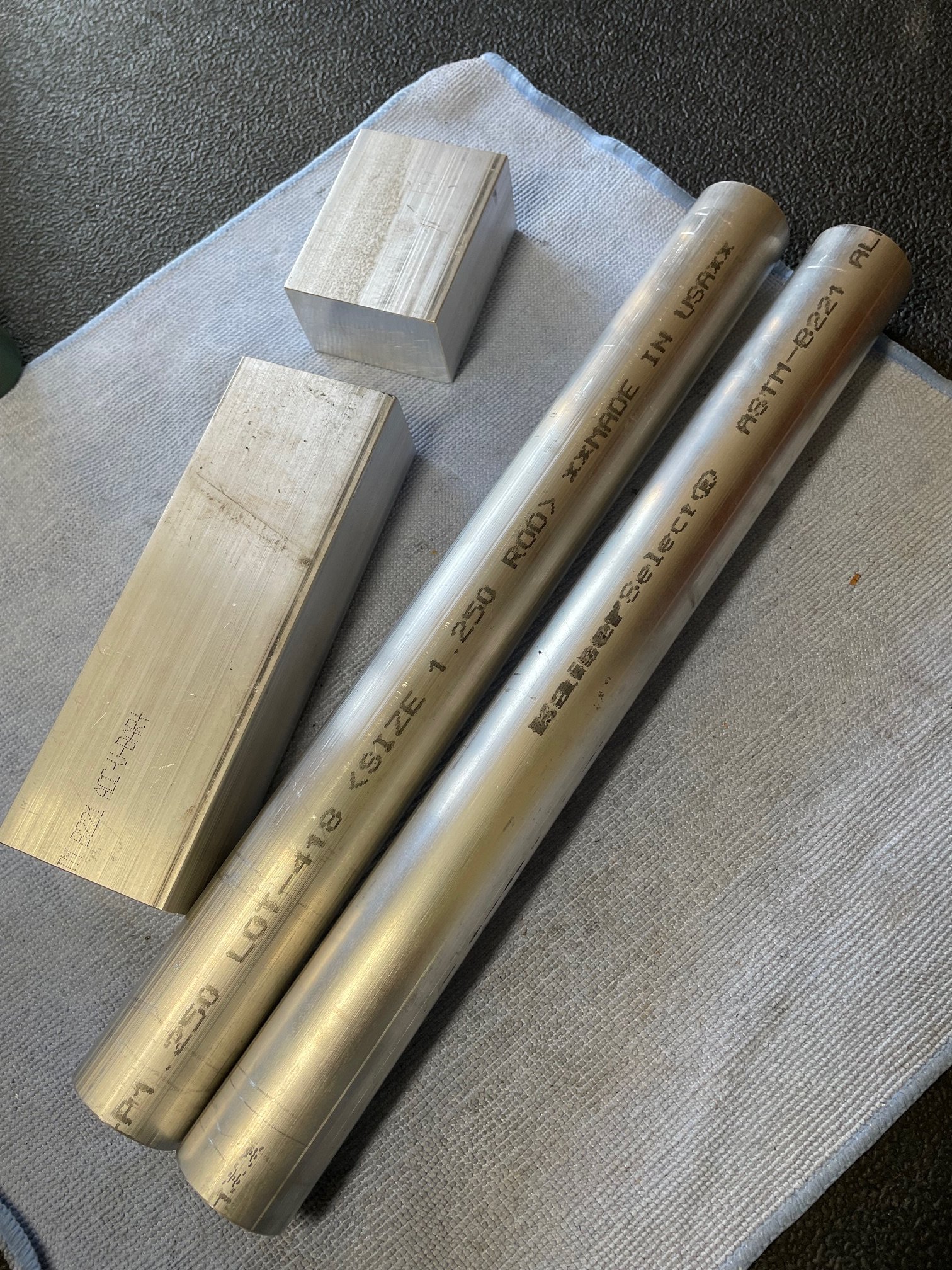

Receive ordered mat'l. today, manage to cut a piece for the 2240 adapter. This are ASTM rated alloys, the only type I use where pressure is 100 bar or higher.

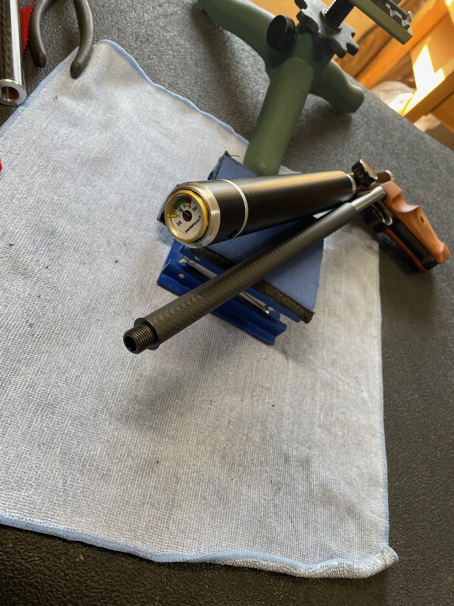

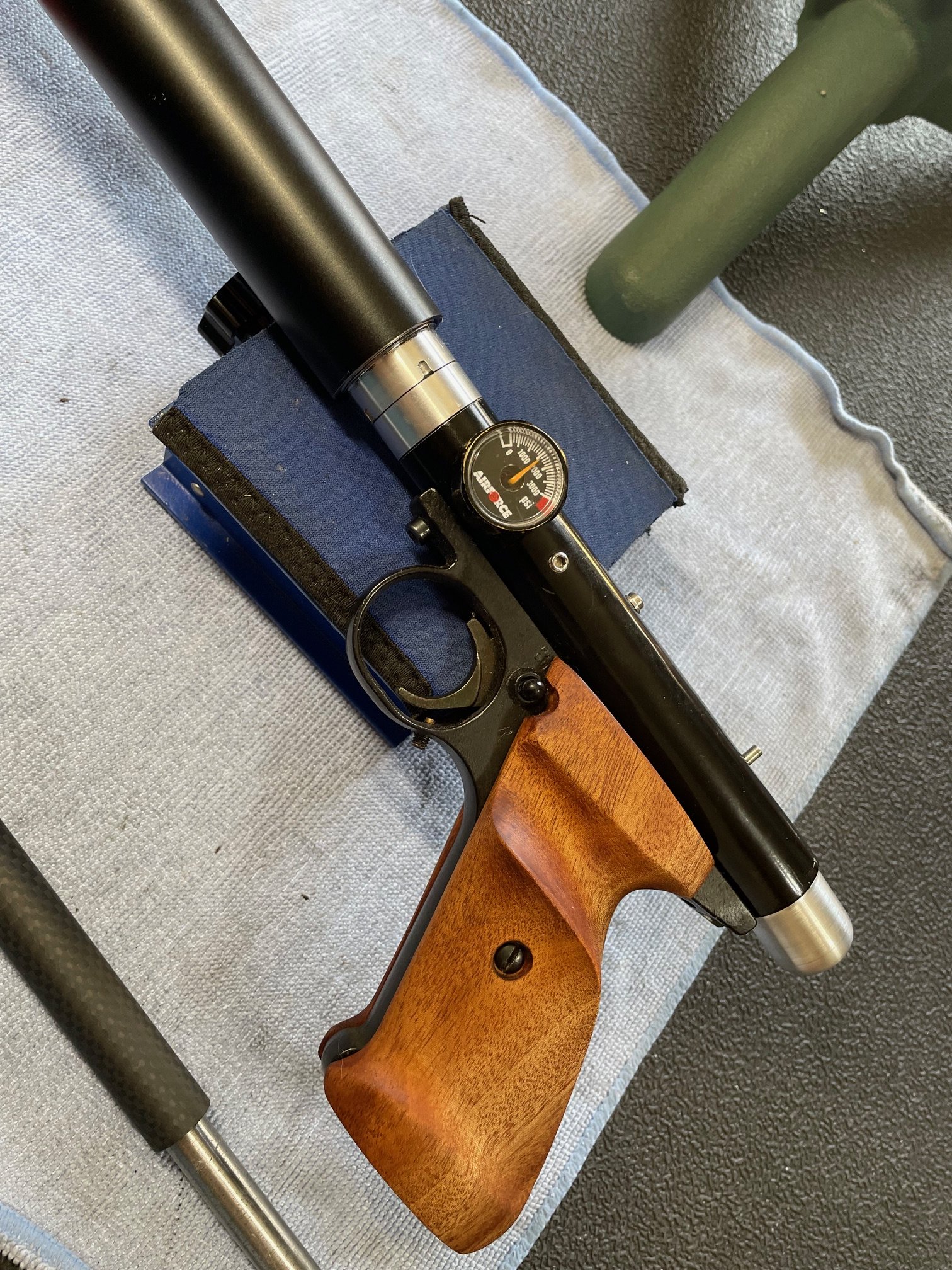

Woa! Haven't spent a full day working since I retired, lol. Got a lot done on my 2240 project. Got the adapter for the Notos tank finished and mounted. Adjust reg down to 1600 psi. Cut and crown a crosman 2260 barrel and cut a carbon fiber sleeve. Test fit grips, boy did I miss up, screw hole is off on left side. Have to stop now and think it through how to adjust this, hope I don't have to make another.
