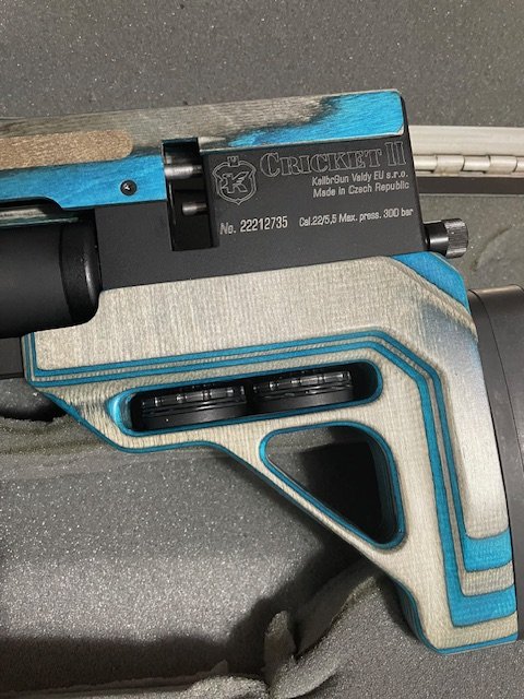

I'm confused, the photos you posted are of a Cricket Tactical
LOL, my bad. Just looked at it close, time to see the eye doc again.😁

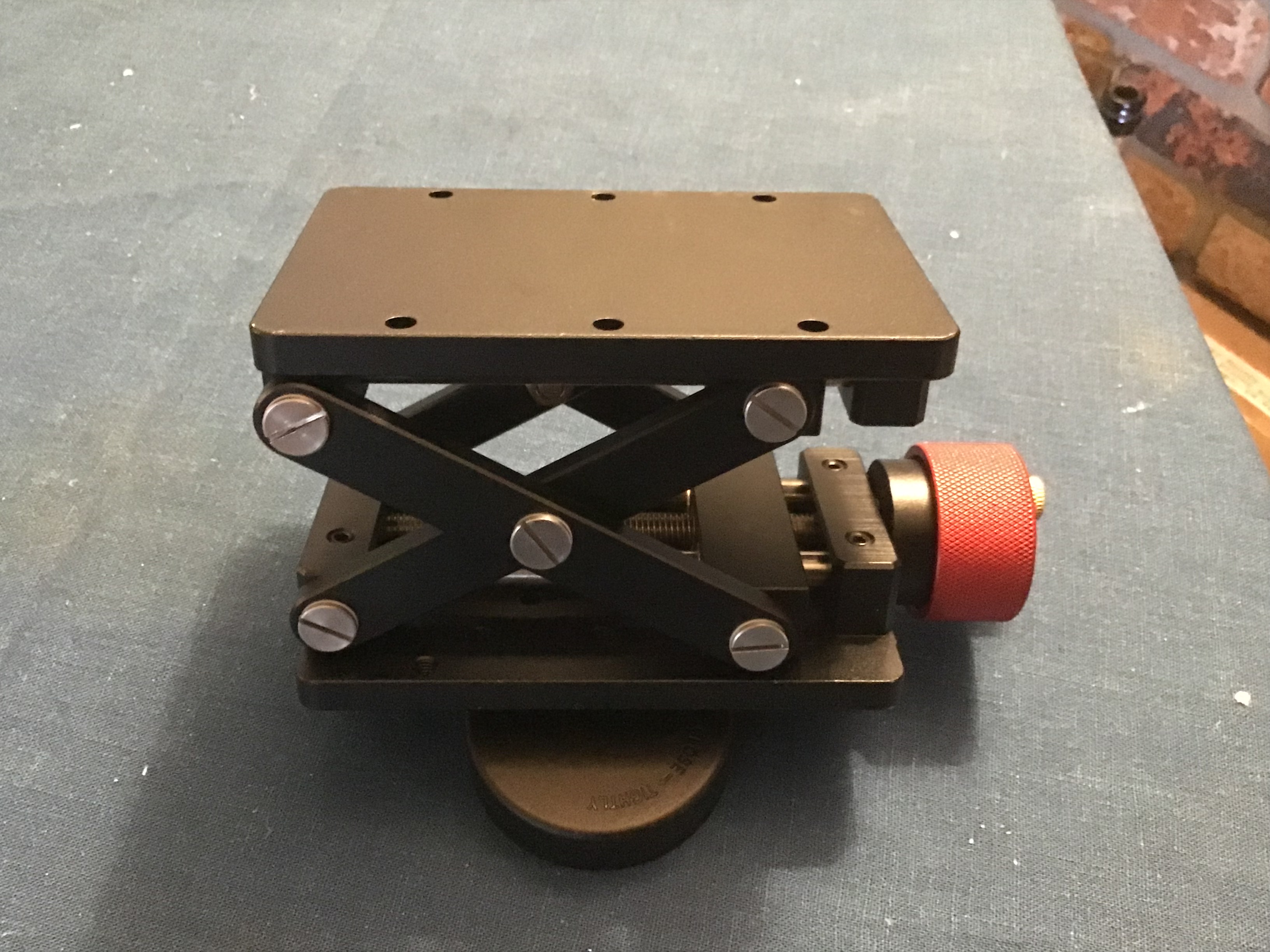

I made myself an adjustable rear rest. ..or you can possibly use as a front rest as well
I wanted more stability so i can do some long range shooting and benchrest. All the other products i saw were either much too expensive or looked flimsy.
The first thing i got was called a "Lab lift". You can find these on amazon or ali baba. They come in a variety sizes and build quality. The first one i purchased was only 17 dollars, but it didn't have a Lock on the elevation wheel, so some friends recommended the 2nd one i got that has the locking wheel

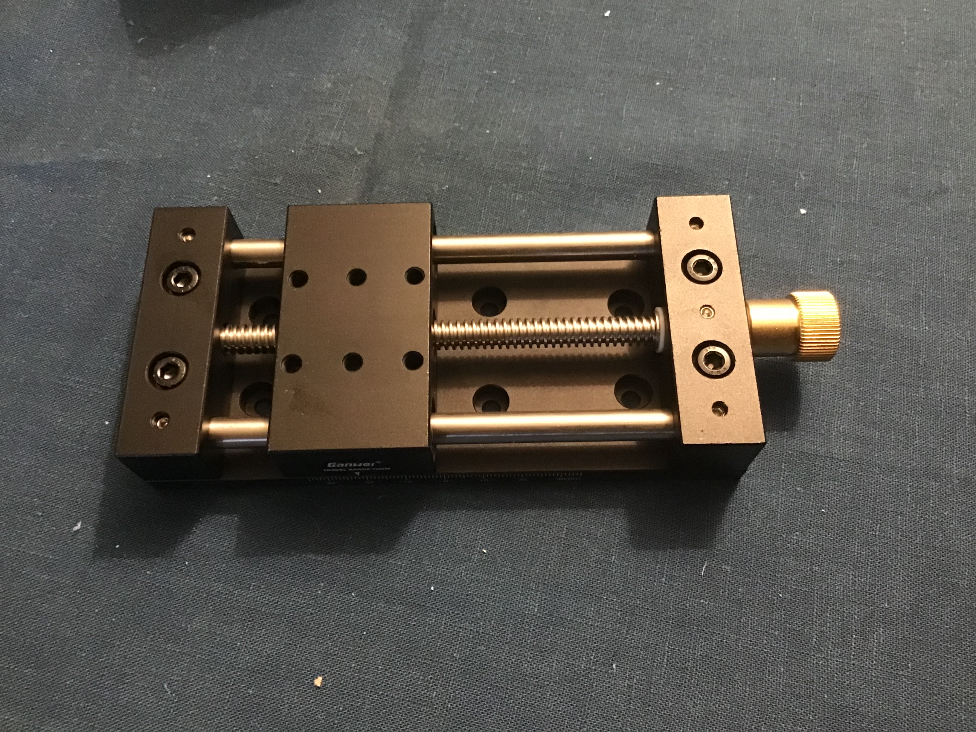

the next piece is a Linear stage table. Also found on amazon and others ...be aware of how much total height the stage is. Don't want to start with a table that is too high and are unable to adjust lower. The minimum height of both pieces is a lil less than 4 inches without the bag,
I still need to get some screws to attach the stage to the lift, but i can't find the right ones...i can always expoy it
Total cost ..minus shipping was around 100
build your own and save some cash!

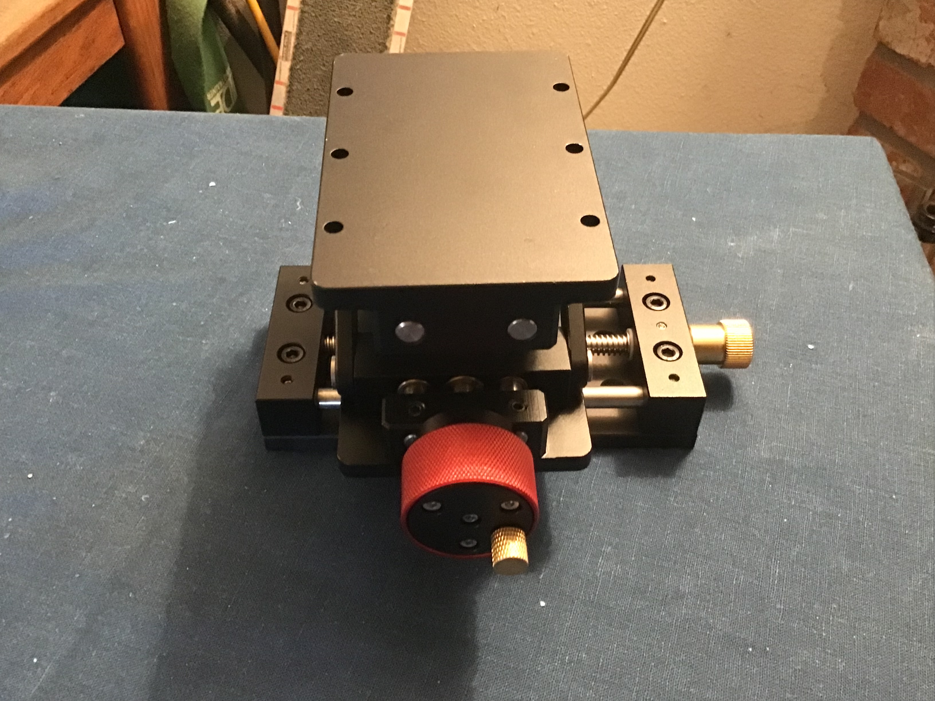

Mike
That pretty cool! your very handy.

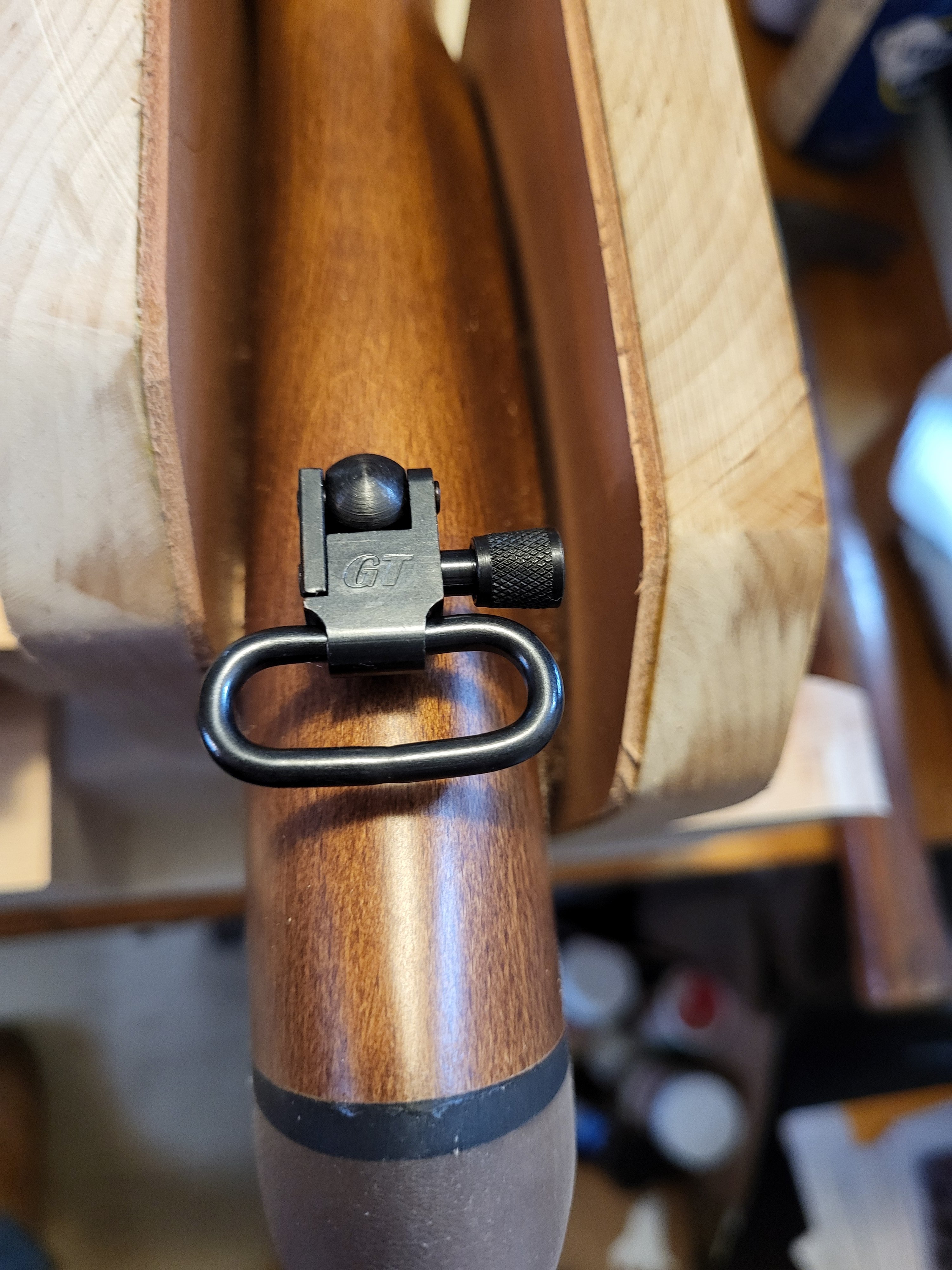

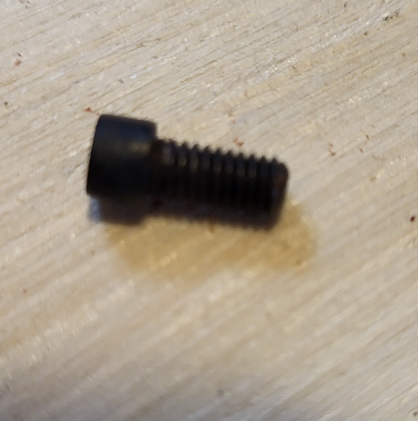

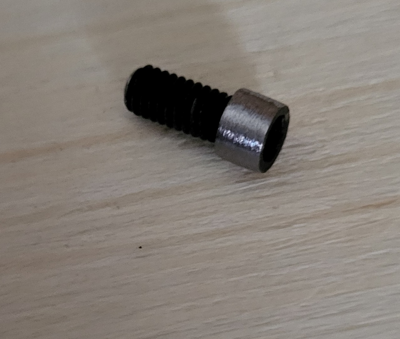

Part 2...the sling mounts and swivels have arrived.....missing a different part this time. Fortunately it was a bolt for the barrel clamp, and not half the clamp like last time. I had 1 with a head too big, and too long but the right thread. Fortunately I lack in regard for my fingers with the belt sander and modified till it fit.
a little re-bluing and you would never know the difference.
Everything installed and looking right...but my sling is still in TX.
