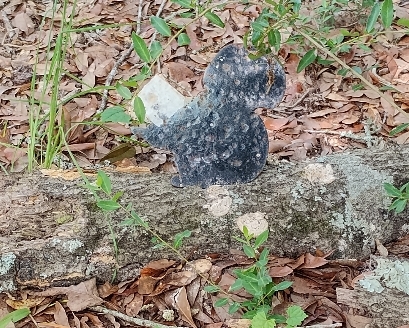

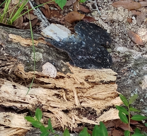

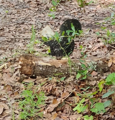

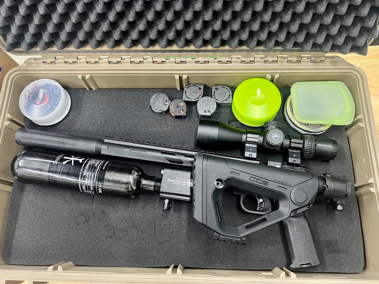

Put a bunch of .25 FX 26gr hybrid slugs through the HM1000x. The results were okay.

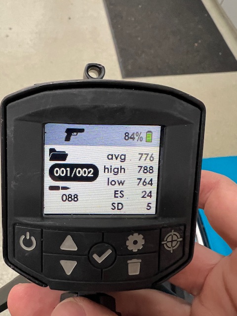

Tried my always good H&N Barracuda 30.8gr. At the current settings it REALLY likes the Barracuda. 45 yards and hole in hole or almost hole in hole.
But dayam does that gun eat a lot of air. Glad I figured out how to fit a 1.1.1L bottle on the rifle.

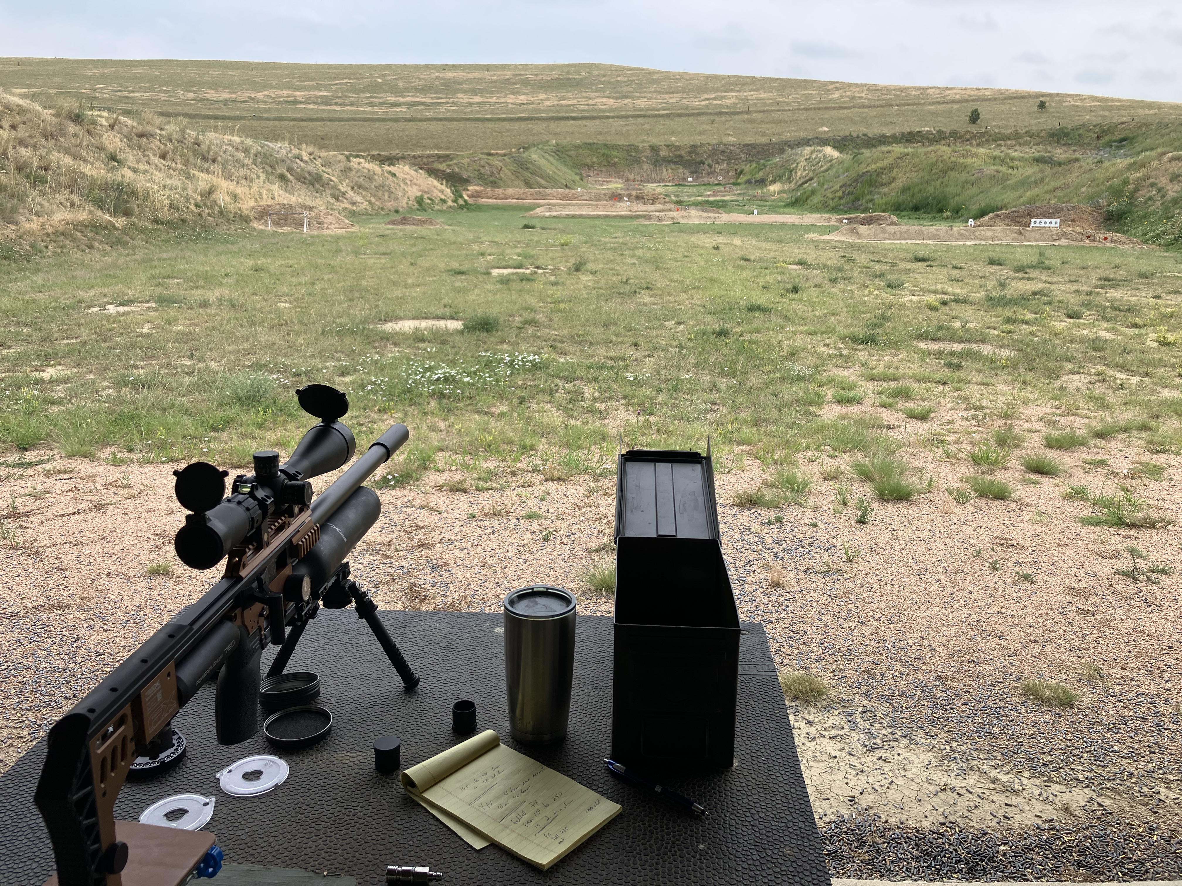

Did a power tune on my Zelos . Worked the reg , and hammer spring together gentle increases untill the 28 grain HP slugs were going 900 fps.
2750 on reg 5 turns in on hammer spring. That's it there is no more. 50.5 ft- lbs. Wanted 920 to 950 but will have to get , and use the 25g slugs for that.
Reason for fps increase want reach out 100 yards for accuracy test , and fun of it.
