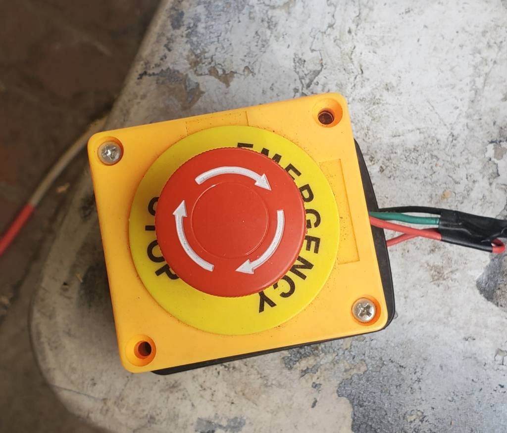

Oh one other thing I'm not sure if you are aware of how powerful that motor is but it can be. In order to push that pump up to 300 bar it needs to be able to force well over 200 pounds down on each stroke. Watch your fingers, hands, and limbs! I use a big red stop button within easy to reach if something goes wrong.
Because the pump has more power than you can pump DO NOT WALK AWAY FROM THE UNIT! It can easily get well over 6000 psi. A blow off disk is a good idea otherwise hopefully only a seal gets blown.
