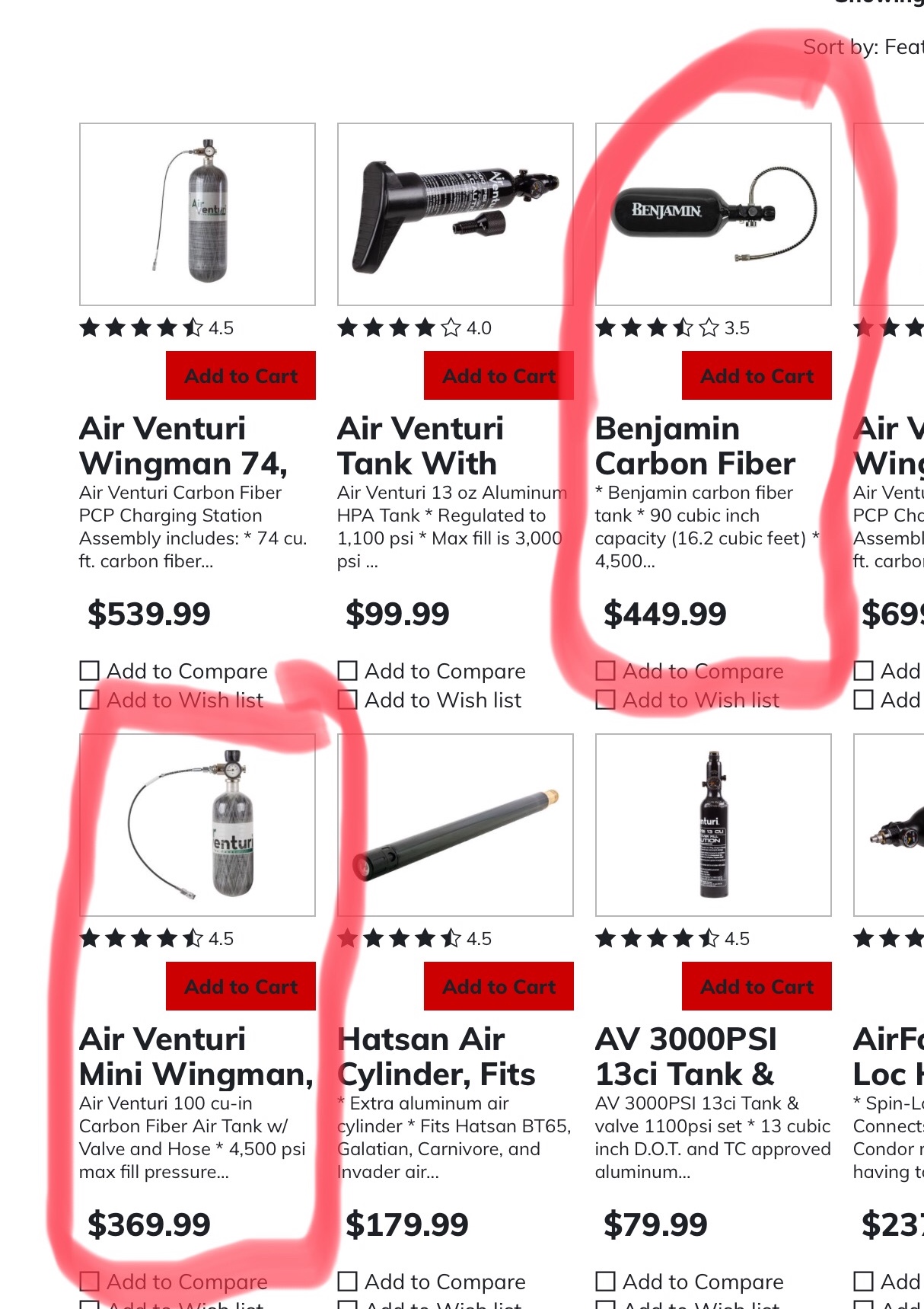

When I had my Marauder I carried an Air Venturi 100 cu in in a small day pack for refills. I think your Omega should be able to top off either of the two shown in the photo. Only downside is they’re a bit pricey.
Reactions: Hopper
