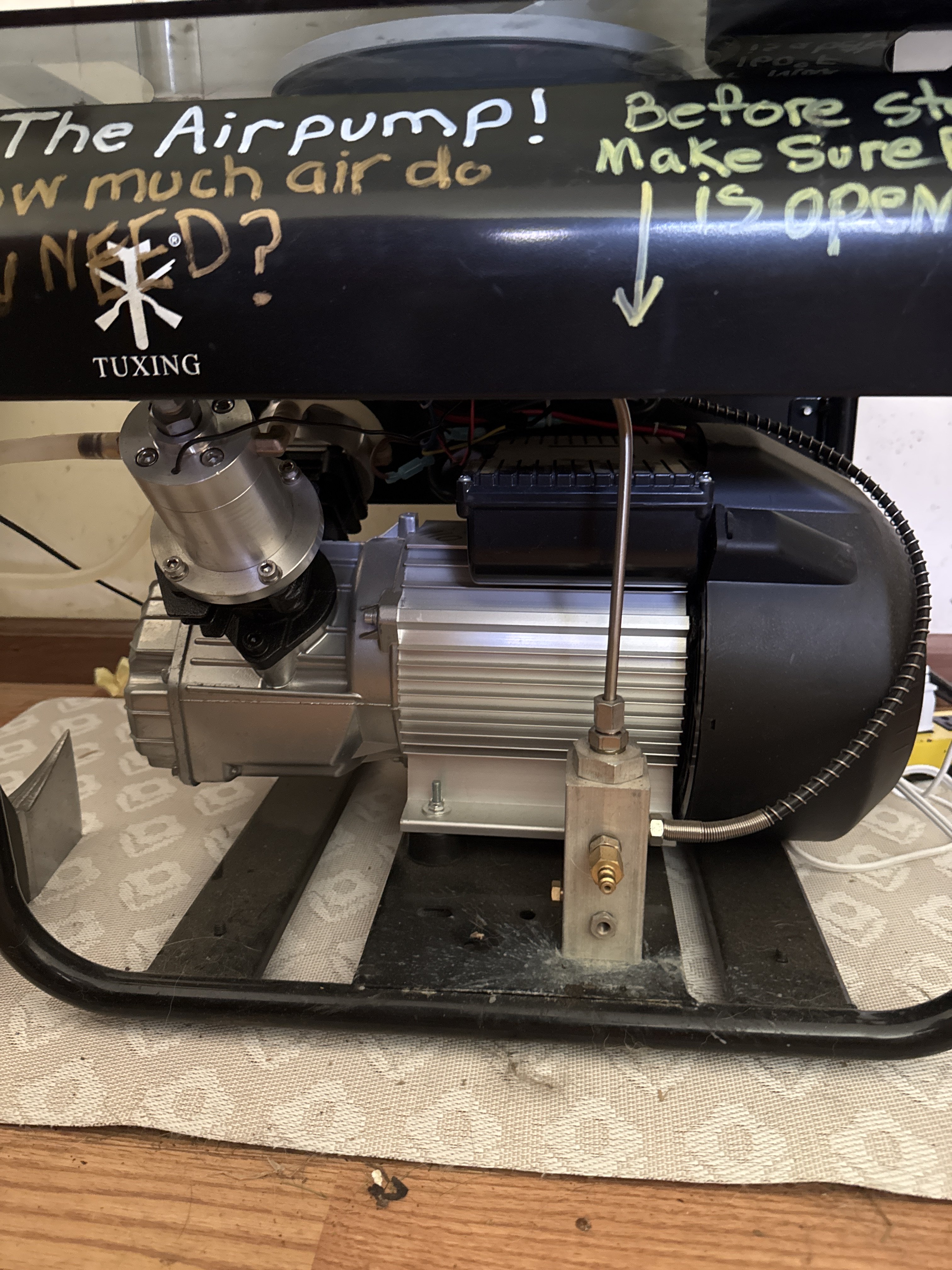

Tuxing makes several versions of these compressors , the one in the pic , assuming it goes through, it was about 450 dollars and you do need cooling water. I have a 4.6 liter CF bottle and a 9 liter CF bottle I keep topped off with the pictured unit. My rifle has .6 liter on board air storage capacity and I can top that off in about 2 minutes or less. Takes about 15 minutes to top off my 4.6 liter bottle. Best feature is it’s a 120 volt standard current motor on the unit. It plugs right into the wall without the need of a power conversion unit. Cooling water sounds like a hassle , but I fixed a 5 gallon bucket full and added a gallon of coolant safe for aluminum radiators and it works perfectly and added coolant prevent mildew or mold from forming inside bucket. I think I did add one cup of chlorine bleach just to be sure. I’ve only made up the single bucket of cooling water. Never needed to change it for a year so far. I put royal purple oil in the compressor, they mentioned it by name in the manual. You can get different versions with added air filters and dryers installed on the compressor unit or you can get a striped down version that isn’t even mounted in a frame like mine , it just has a carry handle on top. I preferred the option mounted into the steel frame but purchased my own filters and dryers to send air through. 530 dollars is the amount of the compressor at the time I purchased it. The reason I went with it is I know a guy that owns a small airgun shop and he recommended those exact type tuxing brand machines. The machines that have low and high pressure compressor units separated rather than stacked up like on a Yong Heng unit has them configured. Mine does 310 bar and doesn’t run hot at all and I don’t add ice to cooling water sounds, unit stays well below max temp topping off 4.6 liter bottle. I have never reached max temp of 185 F , only about 145 to 150 topping off my 9 liter bottle which takes about 20 minutes.
