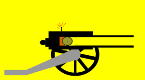

Newtons Second Law states that acceleration is produced when a force acts on a mass. The greater the mass (of the object being accelerated), the greater the amount of force needed to accelerate the object (bullet in our case). Everyone inherently knows that heavier objects require more force to move the same distance as lighter objects. The acceleration of our bullets is directly proportional to the amount of force (burning powder) being applied to them and inversely proportional to the mass of the bullet. This means that how fast your gun and bullet accelerate are going to depend directly on the amount of force applied to it, and the weight of the gun or bullet. We now see a clear relationship between force, mass, and acceleration. It is familiarly expressed as Force = Mass x Acceleration, or F=ma.
The formula for recoil energy is E=1/2 MV Squared, with "M" being mass of the gun and "V" being the recoil velocity.
Let us take : M= mass of gun, m = mass of bullet and propellant, speed of gun before firing, u1 = 0, speed of bullet before firing, u2 =0, speed of gun after firing = V and speed of bullet after firing = v.
Applying momentum conservation principle, Mu1 + mu2 =MV +mv
0= MV + mv
V (recoil velocity) = - mv/M
Gun mass, projectile mass (with the mass of air released with it..), and projectile exit velocity are the primary variables which determine recoil velocity, which then allow you to compute recoil energy. HTH
