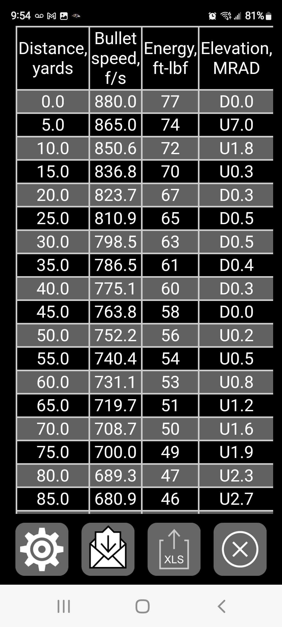

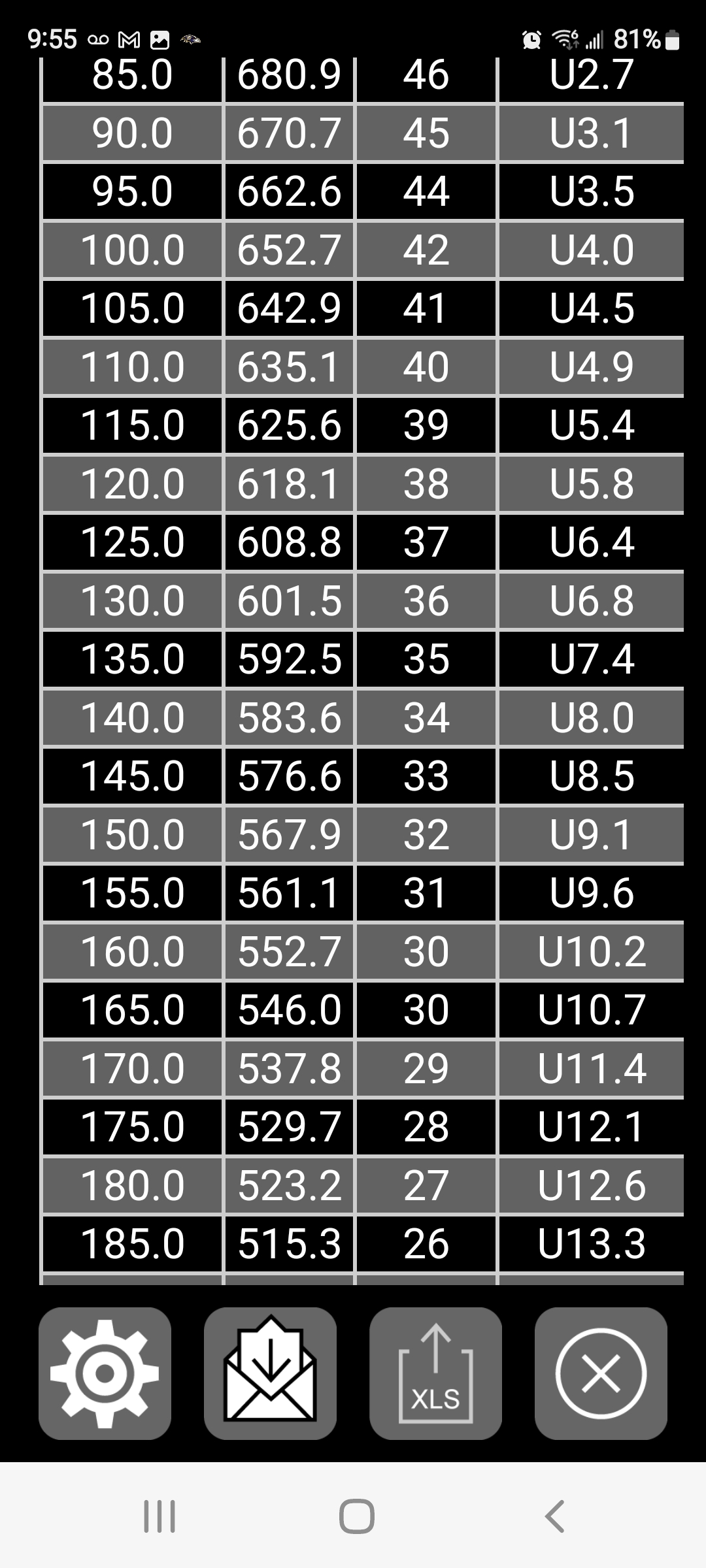

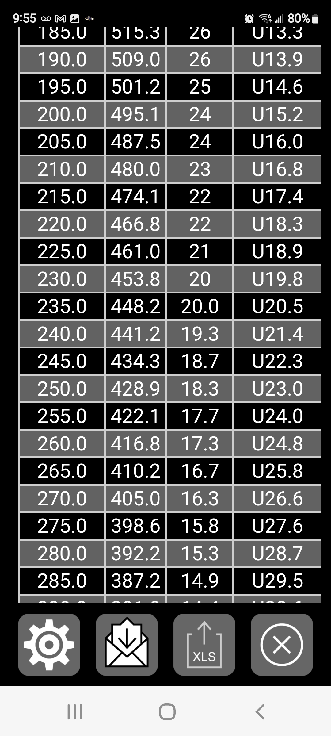

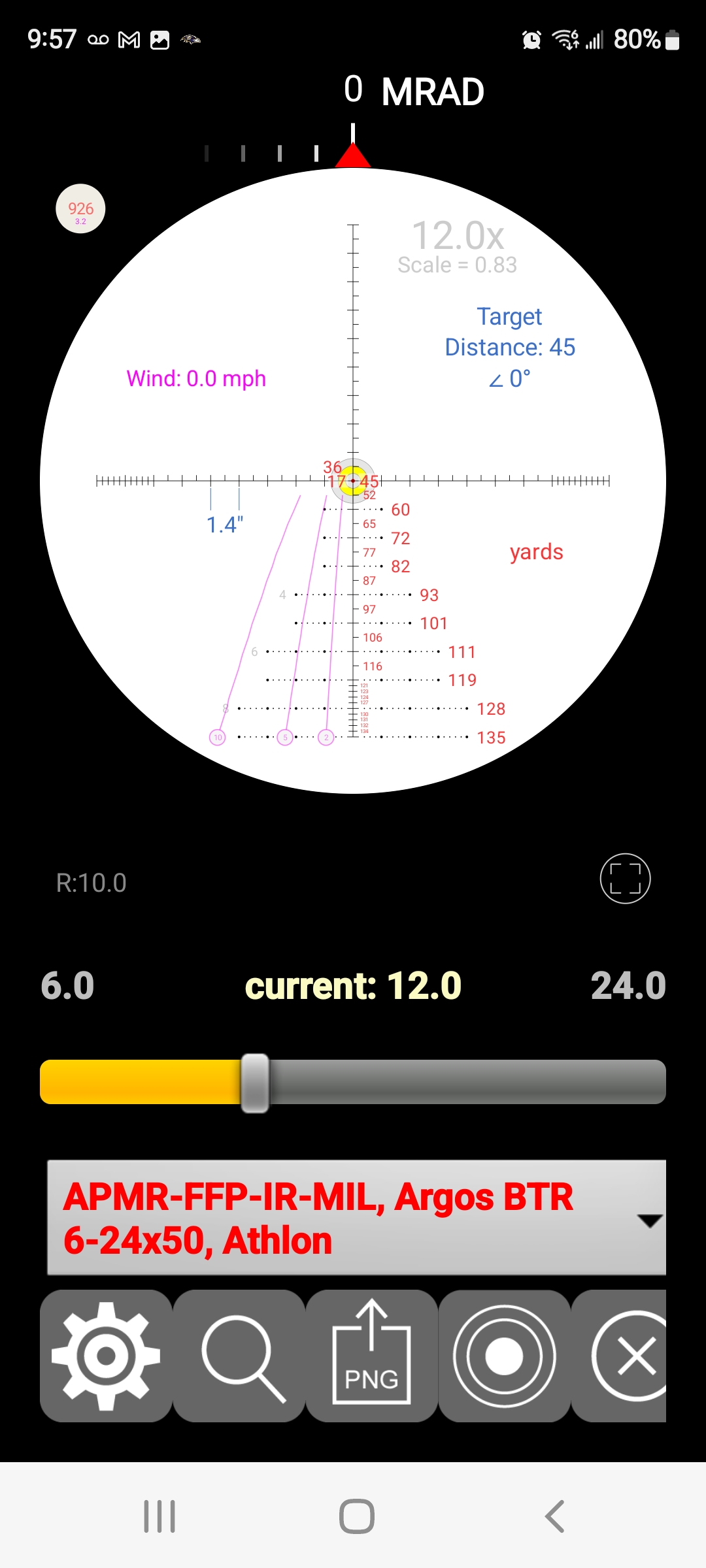

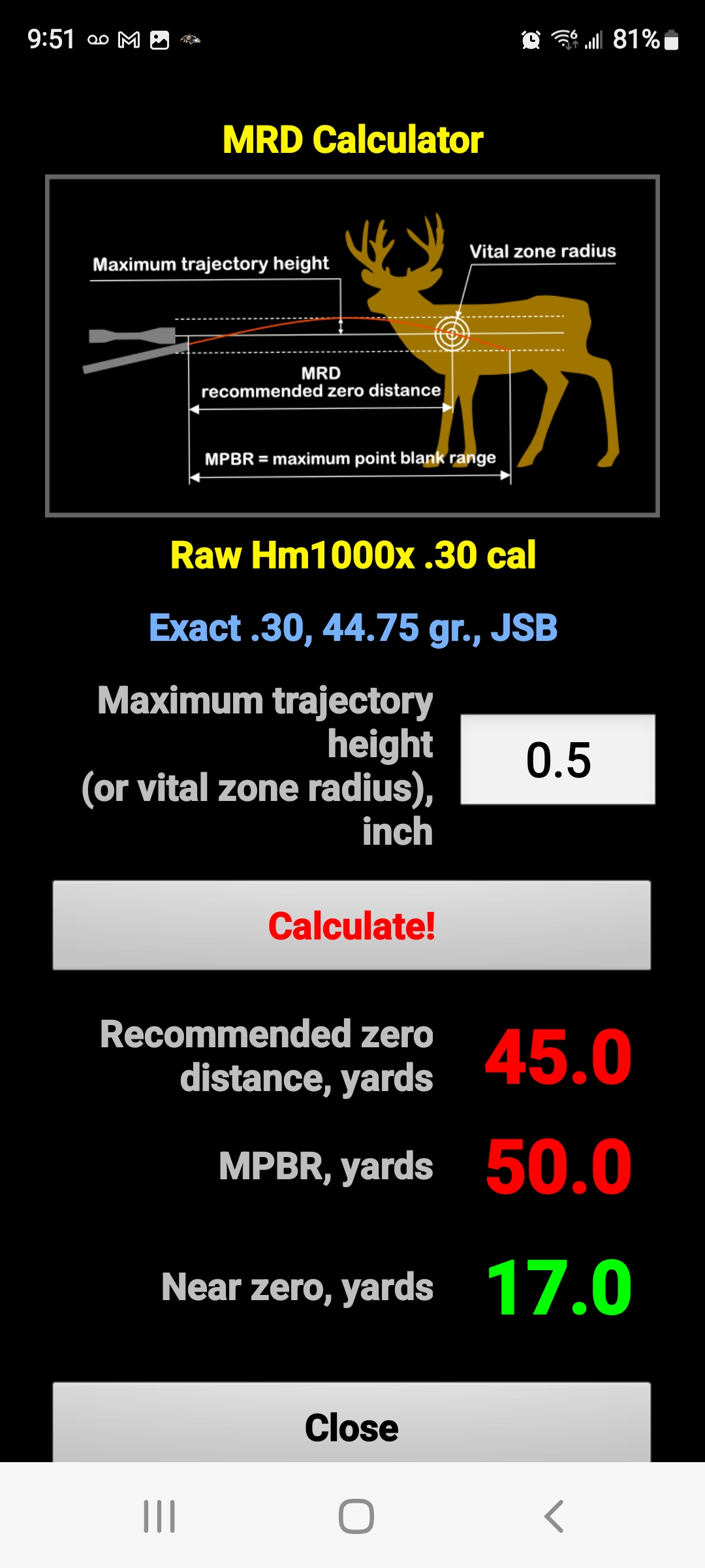

A little .30 data for you on my Raw hm1000x. 30. Hope this help.

This is certainly quite helpful (newbie question - what app did you use here?) It's interesting that there is still plenty of energy for rodents way out at 300 yards (for me this would be beyond my limits humane-kill wise but it's great data.
Strelok Pro, purchase from app store on your phone or tablet. It along with a decent range finder will take your pcp experience to a new level. Just like Golf, it's all about knowing distance to target.

Agree - I have a nice laser rangefinder and have used a few shooting software programs - mostly for 100-600 yard .308 shooting. Consistent velocity and knowing your range are the essential elements!!! I like the simplicity of (your) program and will have a look.
