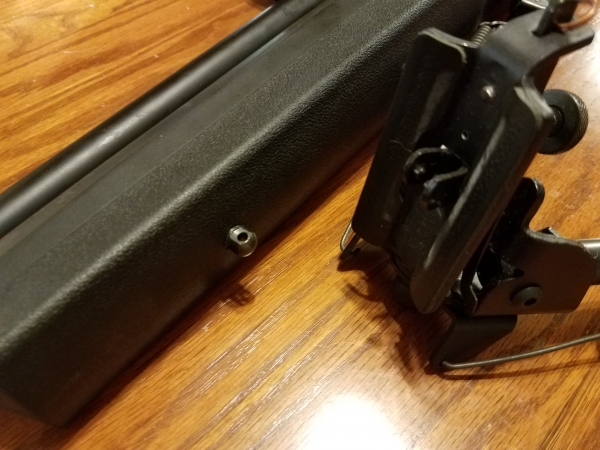

Here are a few pics with the Harris bipod. I prefer the 9-13" model that swivels for cant.
http://www.harrisbipods.com/HBLS.html
The Harris bipod has a clamp with tabs the lock into the swivel stud on the bottom of the rifle. As far as other modifications concern, it depends on how much you want to modify it. There are a ton of upgrades that can be done but others here will have give you more info on that.

The Marauder already has the sling swivel studs on the stock. If shooting off a bench, a bipod that extends up to 9" is all you need. If sitting on the ground, you need one that extends high enough to allow you to get good sight picture. Amazon has many bipods that are Harris clones that work well. The Harris is more expensive than the knockoffs. I use both and have never had any trouble with the knockoffs or my Harris.
