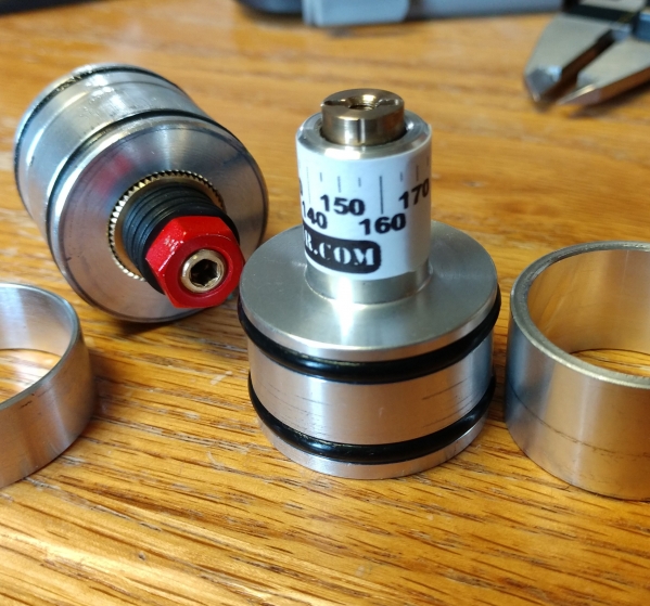

Thanks guys. I've noticed the first few shots are way off the numbers so I don't include them in my shot strings. The factory reg was getting a 26 FPS spread in the 900 range with JSB 25s so I know the gun isn't completely messed up. I've got a 45' range in my basement and was able to put pellet on pellet for a whole mag yesterday.
As far as the reg needing break in time, I've put over 350 pellets through with the Huma in. I'm wondering if I damaged the reg when I initially installed it backwards. I think my next step is a reg tear down. At this point I don't have much to lose. I'll report back my findings.
