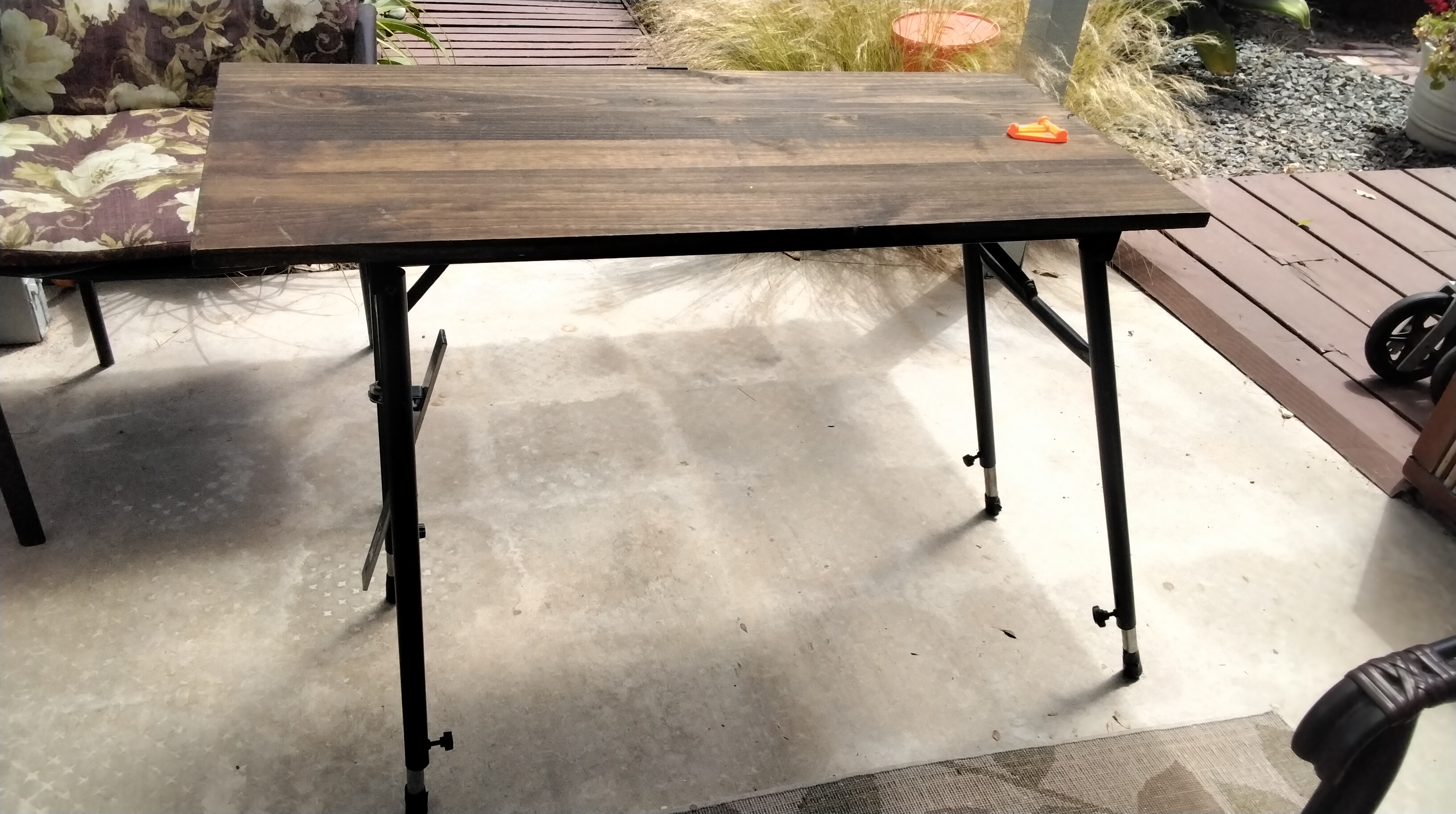

I made my own using an electric piano stand a friend was no longer using. Put a 16"×38" piece of wood I wasn't doing anything with on top & some walnut stain on it just because I had some. The legs are height adjustable so it's easy to level & more solid & stable than I'd thought it would be. You can probably find used piano stands for really cheap. Just an idea to ponder. Took less than 20 minutes to "build". More solid than Caldwell stands I've tried.

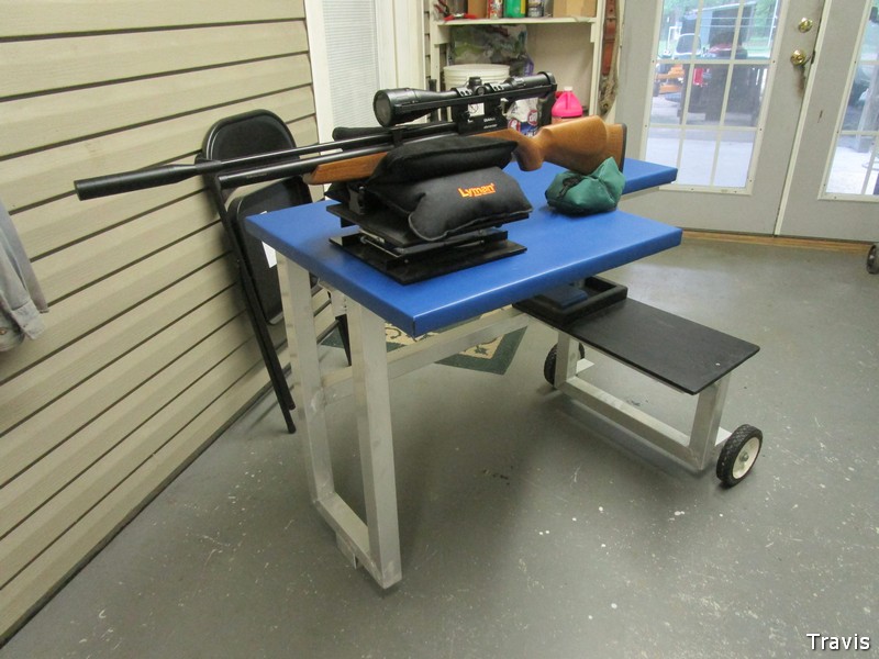

I built this portable Benchrest out of 2-inch square aluminum tube. It has a ½" thick plywood top covered with a marine grade Naugahyde material. I offset the rear wheels to enhance the stance and even though it is portable it is very stable.

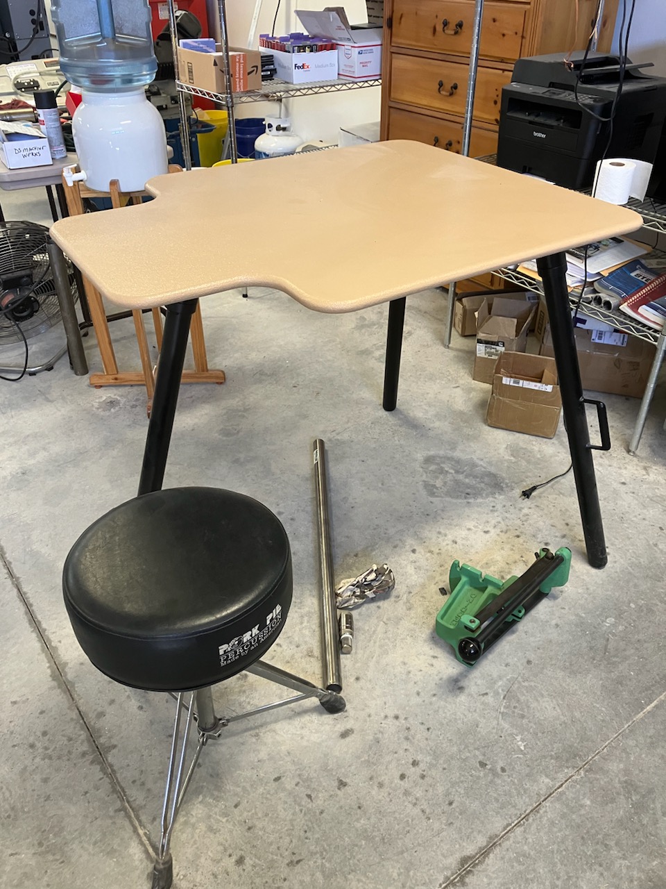

I use this one. It is very sturdy and not too heavy to carry.
