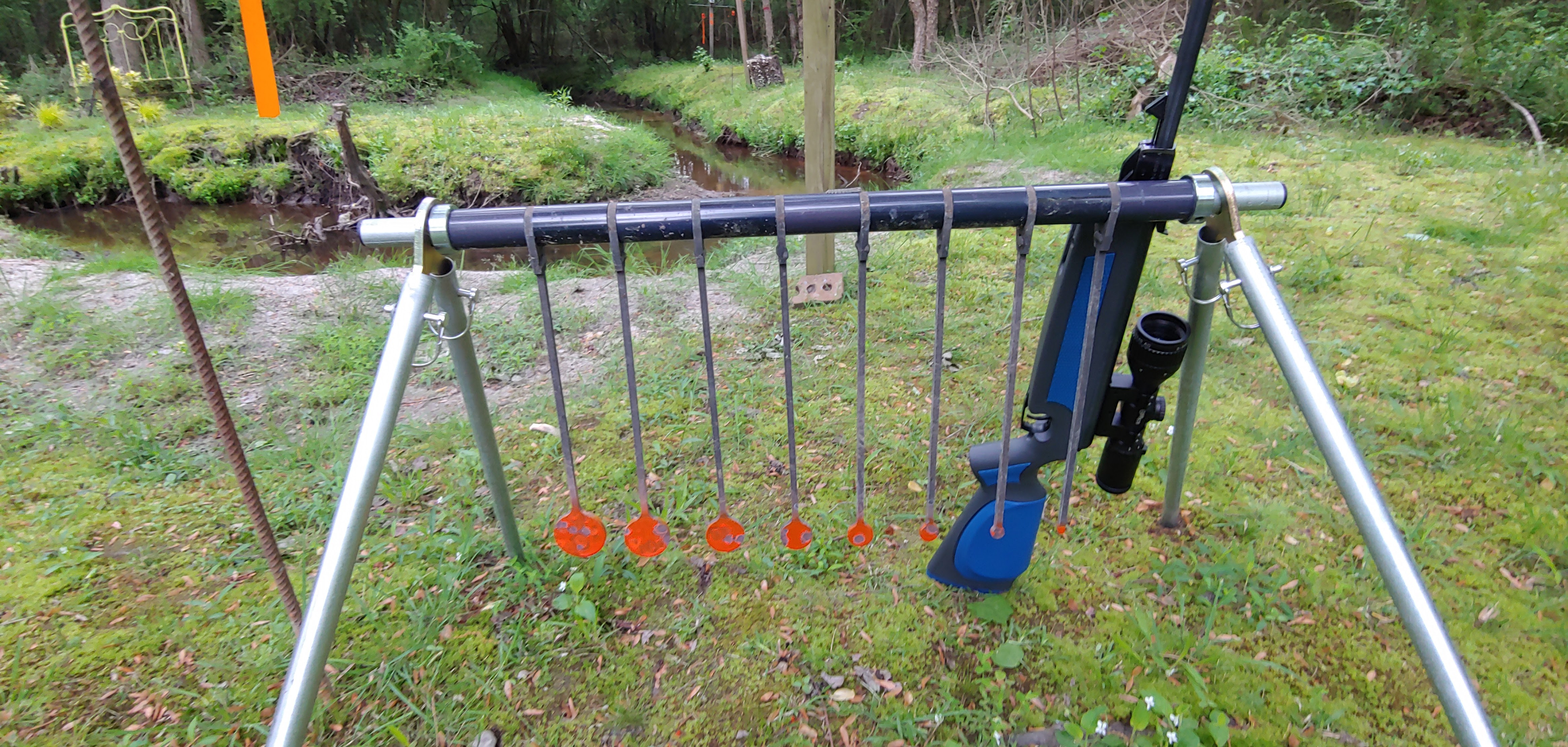

+1 on what was said about Slavia 634. I shoot kyl spinners @45 with no problem.
