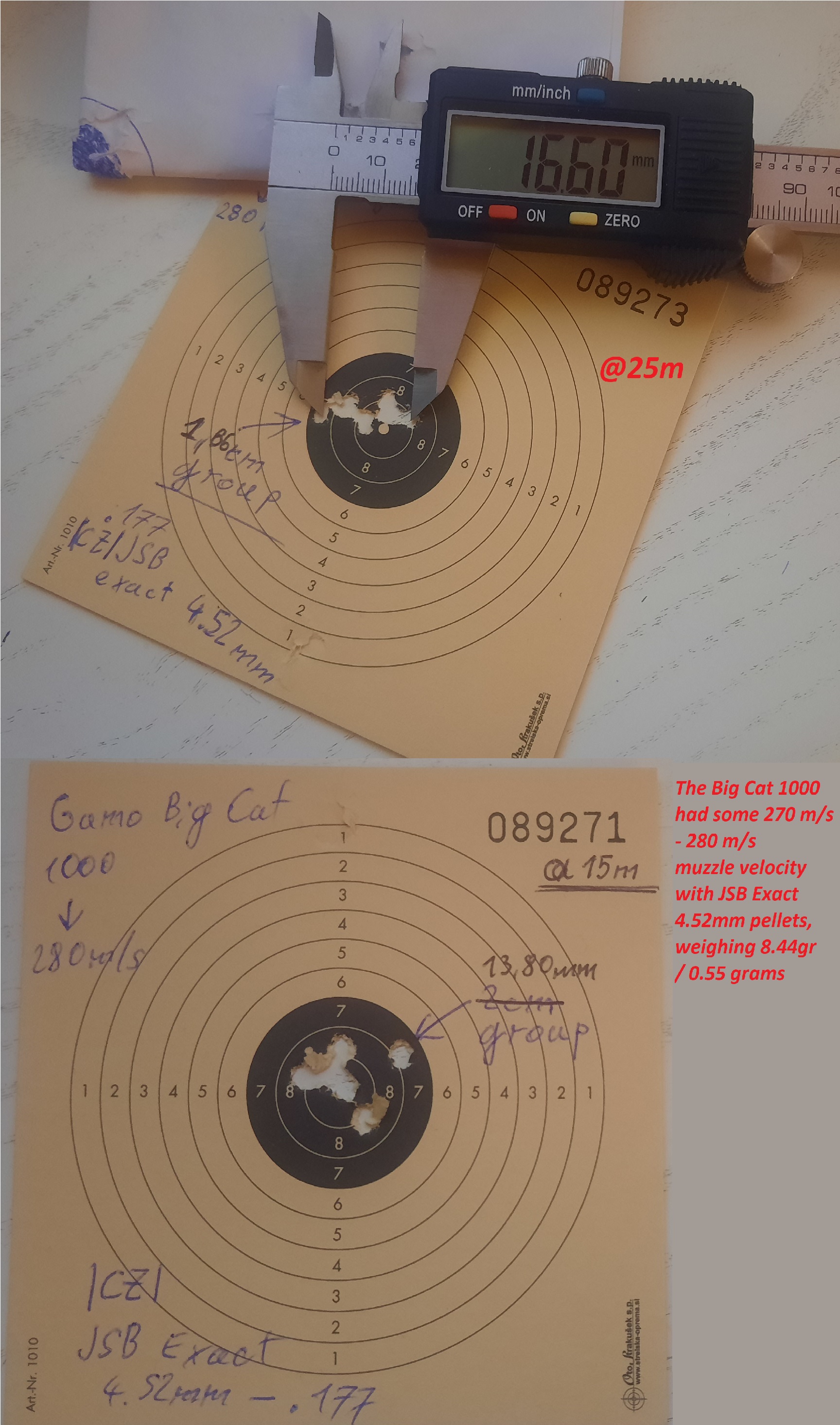

Have a look at a couple of groups, that were shot at 15 and 25 meters, which the Gamo served me with:
I had the gun fitted with an UTG-Leapers 3-9x42mm scope. This is the kind of accuracy I'd be expecting from a good, budget to low mid-end springer.

Both targets show me that the rifle wants to group, yet the shooter is inconsistent. The top target shows two distinct groups which simply means that something as simple as your finger on the trigger position changed. Or your eye position to the scope. The 15 meter group also shows the rifle wishes to group, and that again due to hold or trigger control several flyers snuck into the mix.
Having said this and hopefully taken in a constructive manner, and as you asked for an opinion, well here it is. Grin! There is no longer any Budget air rifles, Gamo and the like are now priced up over 300 bucks. Add 100 dollars to that and you can own a decent HW. All and I repeat All the Gamo, Crossman, Hatsan and other creations can be accurate however due to sloppy triggers, defects in barrels and other variables they generally are not accurate to the point experienced shooters call accurate.

The groups on both targets are good enough for me, I was just wandering whether there are such springers, that would be capable of delivering and keeping such accuracy for the first 1000 rounds... And from what I've learnt from you, there aren't any, anymore. Nowadays, there's only one principle that applies to most companies' manufacturing: Quantity over quality!
Note that this Gamo of mine was customized and de-tuned. It had to be tinkered with, so that it can now deliver such accuracy.
