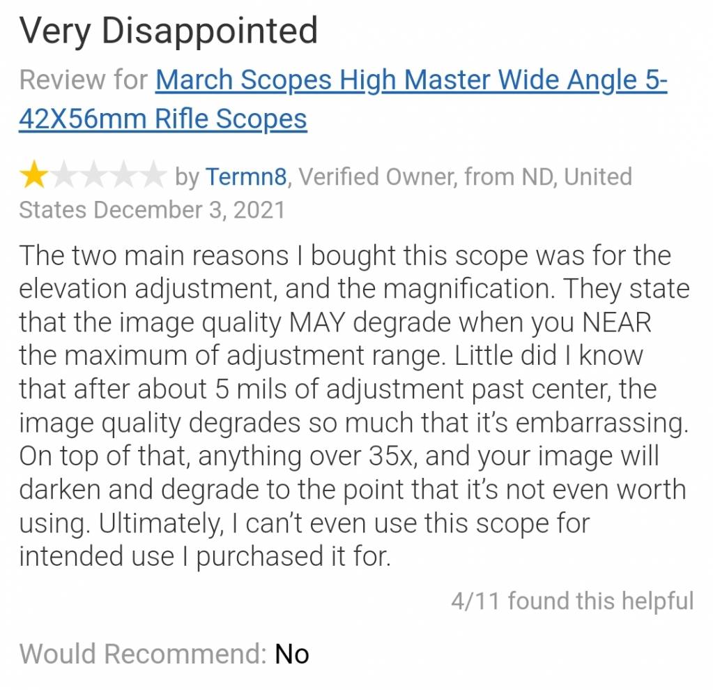

Here is a review with a high end scope that I ran across and it stuck in my head.
