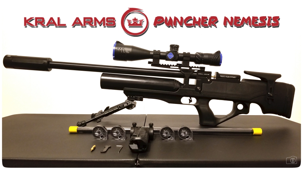

Puncher Breaker
There's my Puncher Nemesis .22/.25 bottle-fed rifle..
As mentioned above, they do have all of the upgraded components,
but they're l-o-n-g . . .
I just measured the length of pull on a few of my different rifles,
and if memory is correct: P15 was like 12", PB @ 14", Nemesis @ 15"

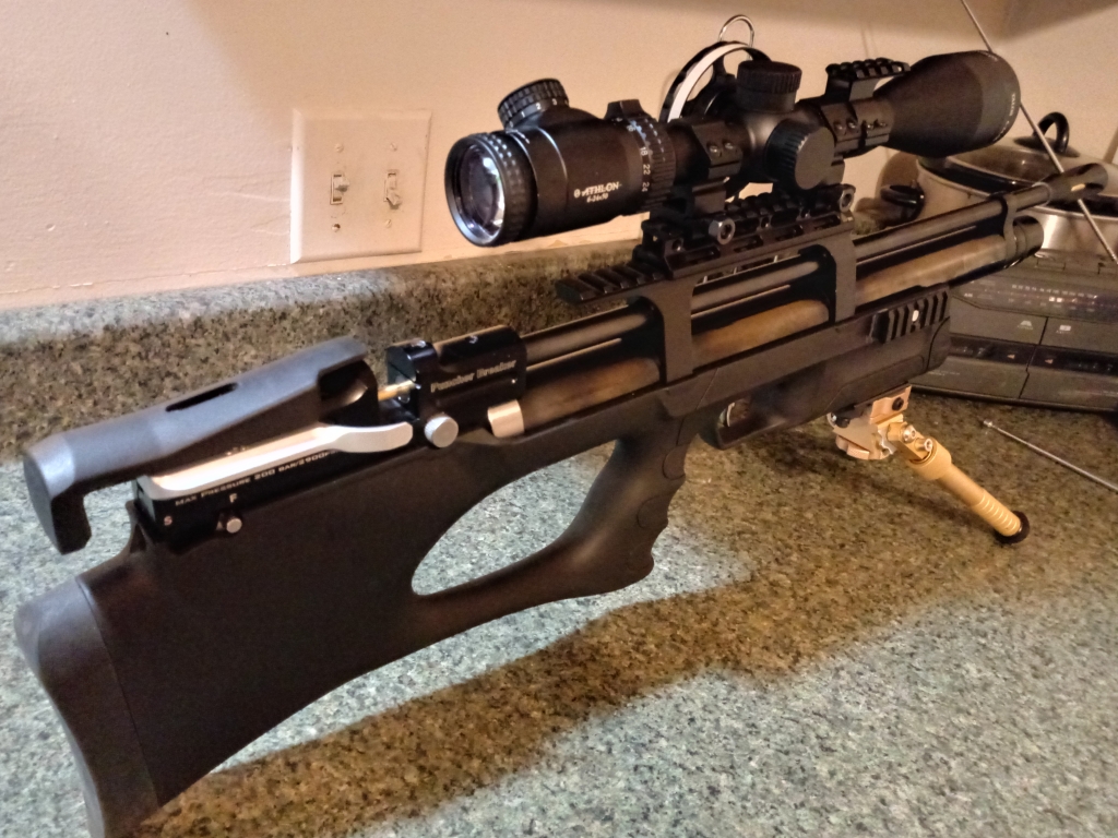

Here's my .22
Ported valve/enlarged air transfer through to the barrel. Polished bolt,hammer (exterior and interior) and related components,de-burred and polished receiver recesses,upgraded cocking handle also.
I'm getting 4 mags at 32-33 ft lbs w/JSB 18.13's and it easily groups 5/8" or less 12 shot groups @ 50 yds
These little guns are simple to work on and Way underrated. I just Love it!!
