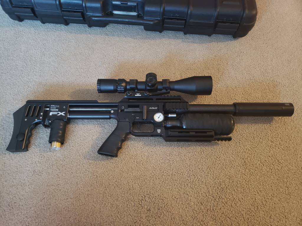

I am going to be setting up my .25 compact as a pesting hunting gun shots will be mostly 50 yards and under I was thinking of using the hades but curious if I should try something else. Any input would be greatly appreciated.

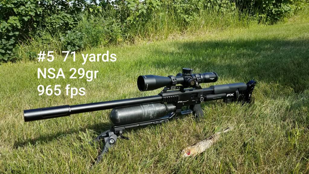

If the slugs don't shoot good close up they sure are not going to do better at longer ranges. My gun often shoots one hole groups at fifty yards with them and mostly MOA at 100.
Kind of depends on your area what you should shoot. Pellets if there are buildings and stuff around you slugs if not or you can be careful with the extra range and power. My slug A liner loves the NSA .250 and VK 34 slugs as well as the JSB 33.95s.

Yeah I want to make this one my back yard pesting gun and also want to take it hunting at other times but again 50 yards max most likely.
You have the perfect scenario for pellets. You can avoid the drama associated with slugs like overtaxing your gun, oily projectiles that attract debris, weird barrel cleaning intervals and spaghetti western ricochets that could and will get somebody hurt or property damaged. You will also maximize your shot count and have an accurate rifle all the time, every day.
