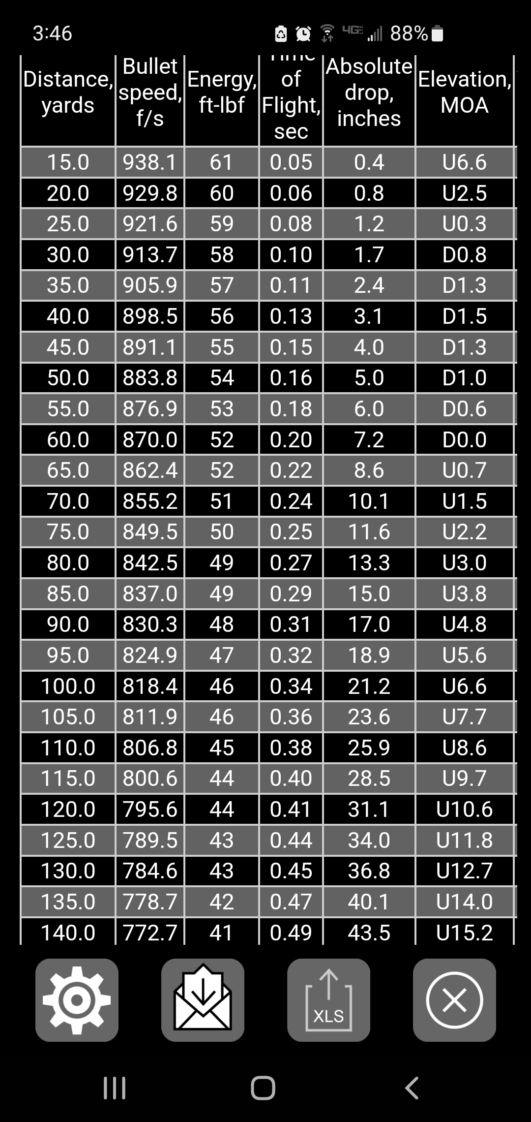

Theres a learning curve and small errors cascade with the impact which makes it ideally suited to the mechanically inclined that like puzzles (me). My impact was set up initially with a helix, 130 bar and tuned for max power to be hybrids at 950, roll the wheel down for monsters as they hace less bearing surface on the bore, and then down in the lower numbers I shot 18gr jsb. Now my gun can't shoot pellets anymore due to state of tune and if tuned lower my heavy liner doesn't like anything but monster redesigns for pellets.
I tested poi changes manually and then found that fiddling with different setups in strelok as a thought exercise was pretty rewarding for velocity and zero distance.
