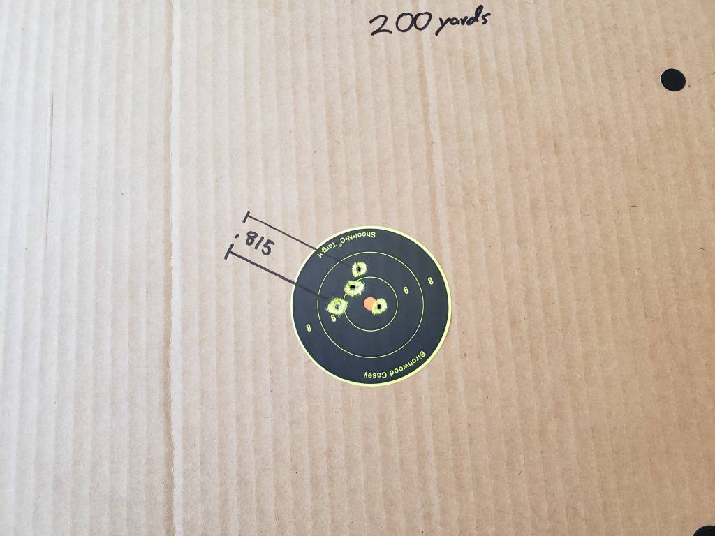

I've posted multiple videos of myself hitting sub MOA targets at over 400 yards such as shotgun shells, soda cans, and 3"-4" balloons. Purposely filmed over water or ravines so it could only be faked by hot air balloon. Still got static. So to post pics of groups would almost be pointless. But.....................I did just shoot a new personal best at 200 yards this morning at the Josephine County Sportsman Park outside of Grants Pass OR with a couple of witnesses. 5 shots in about a 2ish mph wind. No BS.

I don’t think we’re talking about magic groups. We’re generally talking about overall accuracy. Most of the time that would be a series of 5 shot groups shot consecutively. Maybe 5 or 6 groups. That would definitely demonstrate the gun/slug accuracy. In this case above in perfect conditions, but that’s fine... We do like seeing those magic groups, but the point of the OP is the statements being thrown around like those magic groups are the norm, and they’re not. Even Swish... lol Don’t be a hater...

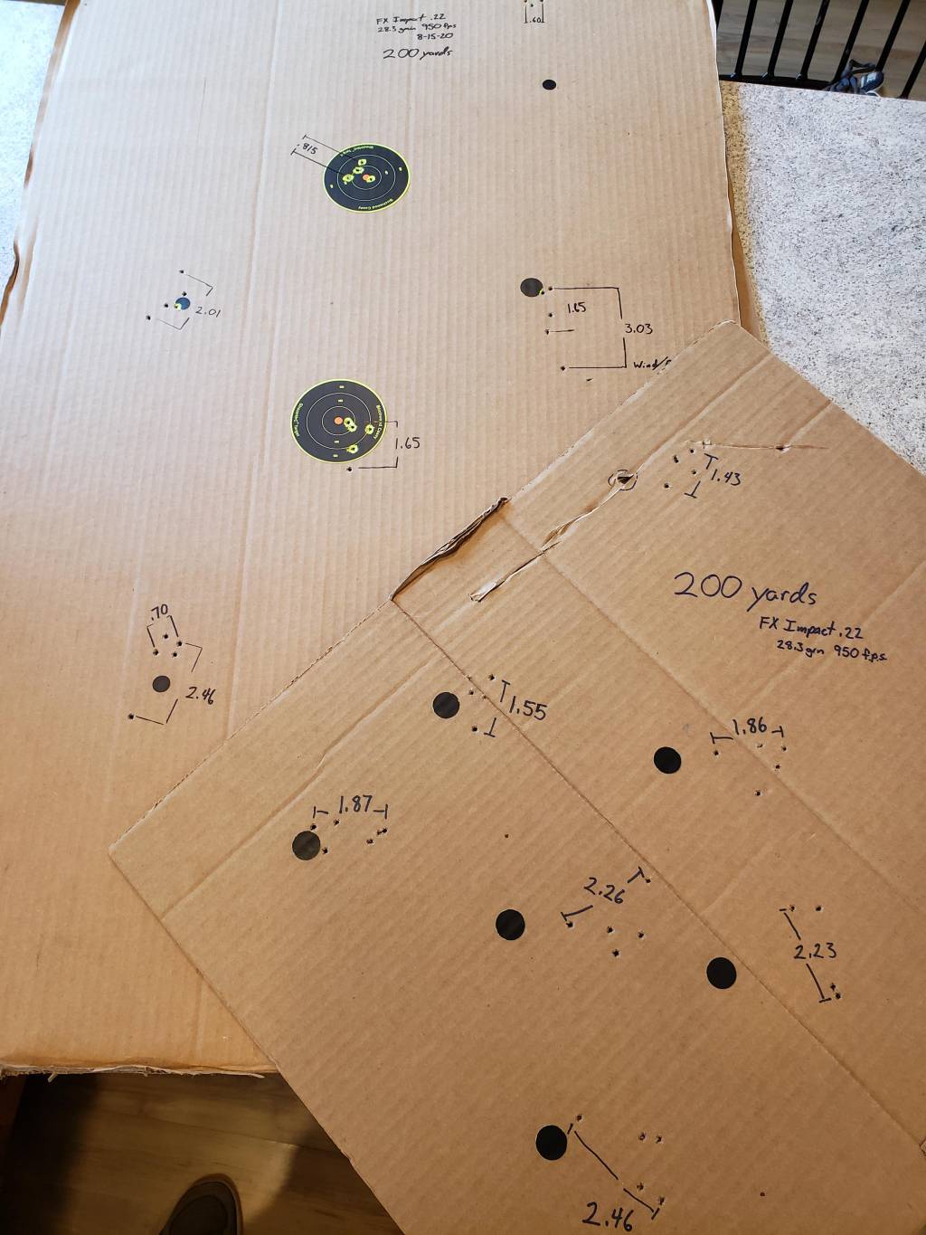

What do you think I would score on the front card if I held for the wind?
I did hold for wind on 3 of the 1.87" group but that was all on that card.
Not a clue, maybe 150? Shoot for score and find out. Let’s not guess and just try it. Even in perfect conditions like your “targets” above... I see a 1 MOA gun at 200 yards in ideal conditions from those groups above.
Damn accurate! You should be commended, but it’s certainly not a 1/2 MOA gun at 200 yards.
