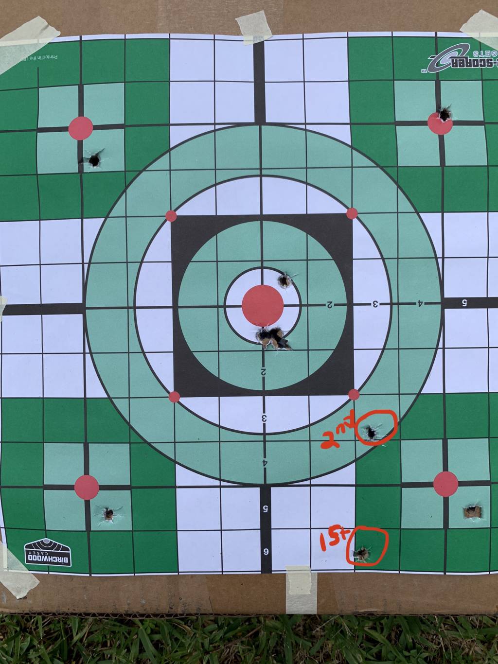

I used a folding table, bipod, and rear bag to sight my scope in at 25 yards. Below is the target.
The first or shot was pretty low. I turned the dial the wrong way and the second shot didn’t hit the target. After making adjustments you can see the second shot (actually the third shot, but second shot that hit the target) rose a bit. I think by the fourth shot I was just about on center. It started raining a couple of times so I was in and outside trying to get sighted in.
My issue is once I got around 25-35 (tenths of a mil) on the elevation dial it appears that the reticle stopped responding. So turning the turret any further didn’t move the reticle to get my zero exactly where wanted it. As you can see, my shots are hitting low and to the right. The couple that hit higher occurred after I physically moved the gun.

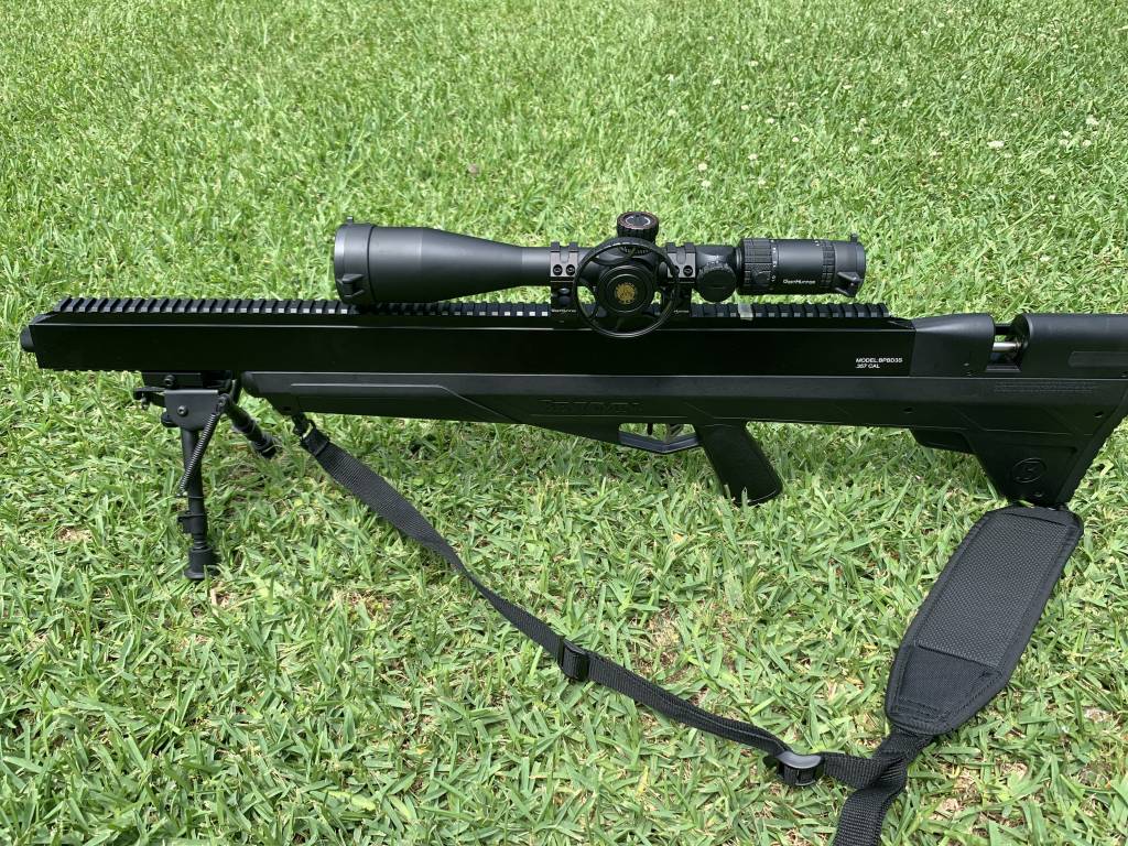

I actually like that the objective bell is close to the shroud without a riser rail. I thought it was more desirable to mount a scope this way. I simply used the high rings that came with the scope.
I have a riser rail that I can add. Thanks for the suggestion. What I’ve found most frustrating in this instance is that the turret continued to turn, but the reticle stopped responding. In the past I’ve had an issue of running out of “clicks” to where either a turret would turn no more or I could literally feel the tension in it and know that the turret had reached its limit. With this one it turns and clicks as if there’s more room for adjustment.
I have a habit of tapping the adjustment to reticle with the butt of my screwdriver every time I make an adjustment. That’s something I learned years ago from powder burner shooting. I know everybody doesn’t do that but I have had a couple scopes years ago that just wouldn’t respond all the time I made an adjustment.But I would believe your problem is What was already mentioned about being too high over the bore.
Gave it another shot, same result. Tried making adjustments and tapping the turret after turning it. That didn’t work. I checked my riser rail and it doesn’t have any built in MOA according to the packaging so I didn’t try using it. Is simply placing the scope on a riser enough or is shimming the rear ring the only way to correct the problem? This is the first time I’ve encountered this issue. Thanks for the advice.
Having it mounted as low on the rail as you can while getting a good cheek weld would actually bring your POI up. The best solution is to get either a picatinny rail riser with at least 20 MOA built in, a pair of adjustable scope rings, or a single piece scope mount with fixed MOA built in. Your best bet is to get a once piece scope mount with added MOA built in. There will be less weight to deal with and less screws to tighten. An affordable solution would be to get the picatinny rail riser with MOA built in. I personally don't care for shimming scope rings. Do a search for "picatinny rail riser MOA" on Amazon and you'll see several offerings with most in the $20 price range.
