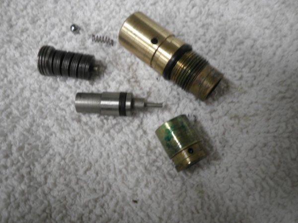

Got the regulator out and disassembled. I'll clean the green off it tomorrow night, IT was a bit difficult to get the inner half out, and the piston was quite stiff in the bore. Not sure if either of those matter but I guess I'll see.
This is like whack-a-mole.
I cleaned up the regulator and changed the three seals that Rodeo mentioned. Like Rodeo's, the o-ring on the piston was dry, compressed and brittle. Reassembled it all and it leaked from the front of "part 38'" as XTX calls it.
Stripped it again and replaced the two o-rings on the front of part 38, reassembled it and now it leaks from the back of part 38.
I guess tomorrow, I'll strip it again and replace whatever seal or seals there are in the back end of part 38.
This has been pretty stupid. So far the fill port leaked - fixed it, the bottle seal leaked, fixed it, the regulator leaked, fixed it, front seals on part38 leaked, fixed it.
And it still leaks!

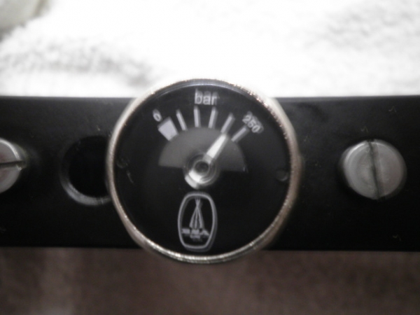

Wait a minute, it's leaking from the bottle. Had to loosen the bottle off about an eight of a turn an the leak stopped - perhaps that bottle has been on and off too many times and I need yet another bottle o-ring? Anybody have a bottle that can't be dead tight or it leaks?
Pumped it up to 3000psi and so far no audible leaks.
We'll see how it is tomorrow. Fingers crossed.

Thanks. I assumed that the bottle bottomed out on the brass fitting, and that the right amount of space was designed into the fitting. If that is simply my mistake then I might be golden this time.
Yup, fingers crossed for the gauge inspection when I get home.................
