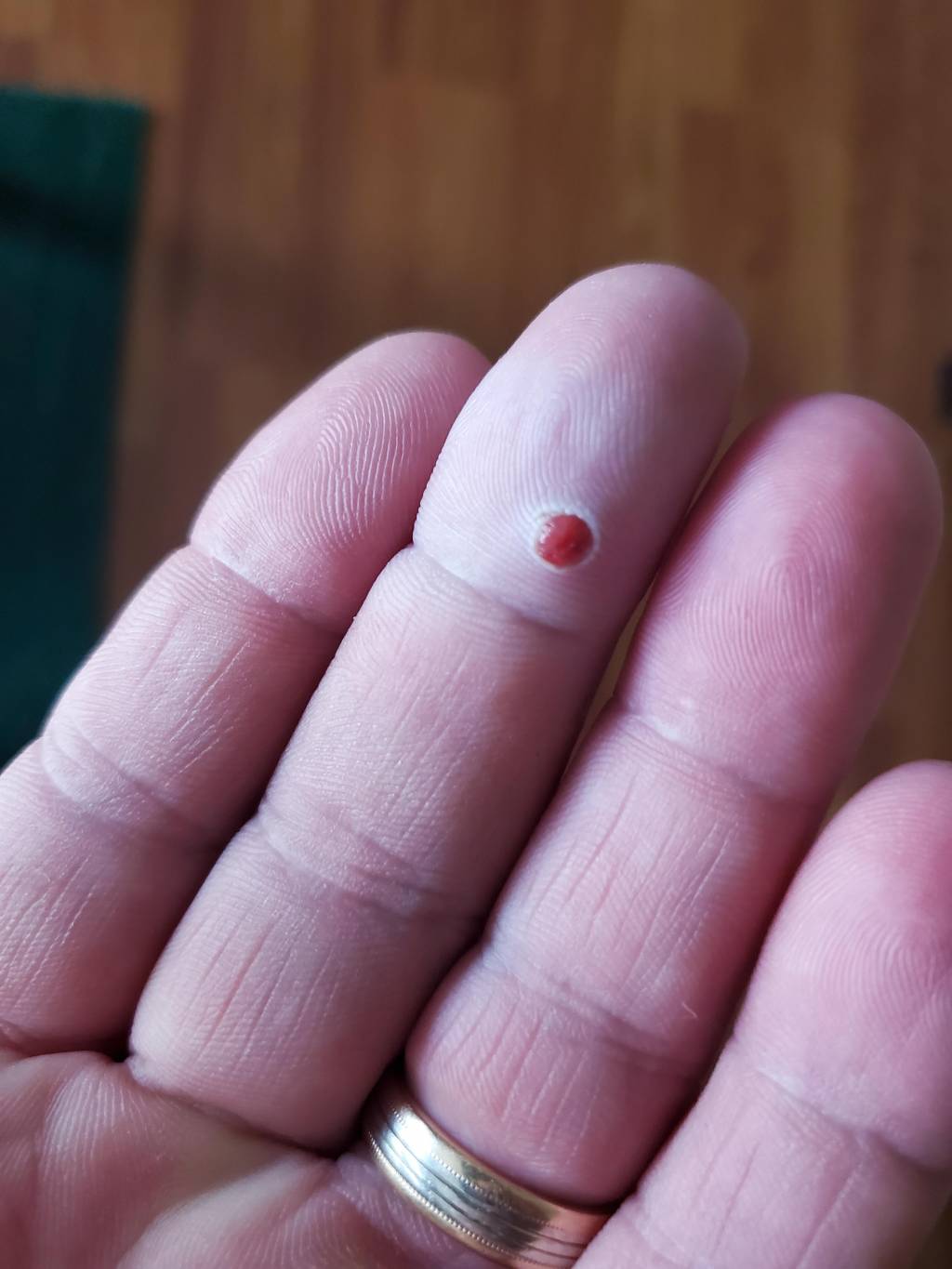

I know that feeling of "oh sht" I just shot myself. Had it happen a few months back. My Huben leaked the air out while in my gun cabinet. So I took it out to the garage to refill so I could find the leak and had it laying on a stool while filling. I didn't think to check the mag or rotate it to an empty chamber before I started. I was standing between it and the air tank and as it filled it went off. The 18 gr jsb stuck in my left middle finger that just happened to be about a foot in front of the barrel. Luckily it was only going about 350 fps or so. I had to pull it out with pliers.. worst part was my grandson walked in and saw it . I felt so stupid for not checking the mag first. Just glad I didn't shoot him. Definitely a wake up call about safety.
This pic
 Is after I pulled it out. Never bled but it did do some nerve damage as my finger tip gets cold easy now.
